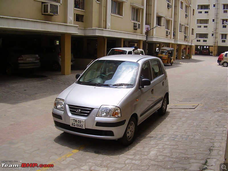

I drive my father's Santro (Zip drive) from 2002 onwards. Even though I am satisfied by the performance, I was thinking of another car like GM Spark. I did a thorough research and analysis before this purchase and realized that there is no other entry level hatchbacks with this much convenience, practicality and reliability. Hence I bought a used Santro from a known source. Its an XO variant (2006 Aug) in Bright Silver which covered 40K kilometers. But the car looks absolutely neat (both interiors & exteriors). I am fully satisfied with the performance till today (Covered approx 500kms).
Especially the service details you mentioned is really helpful. I am requesting you the list of preventive maintenance recommended (if anything other than you listed).
