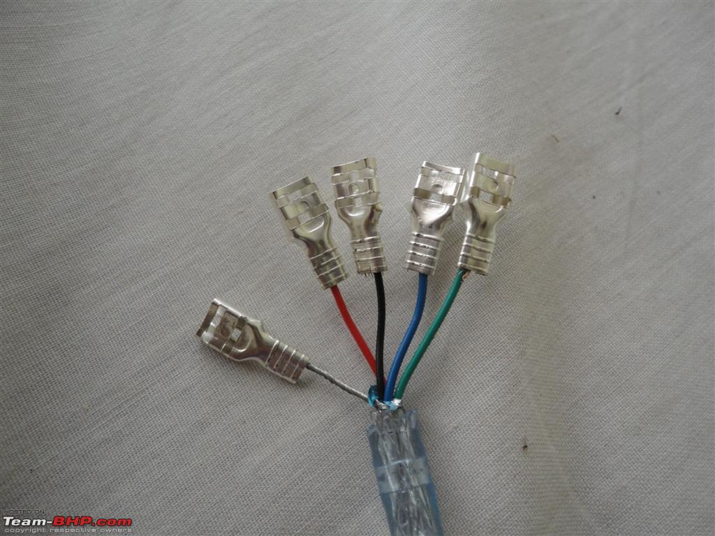

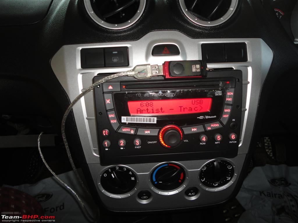

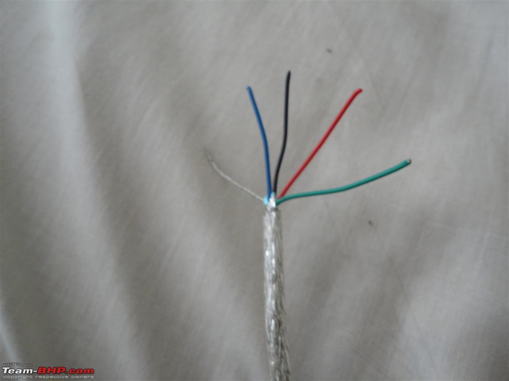

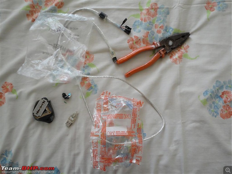

The 2$ USB extension cable for Ford Figo Zxi and Titanium(dont know about EXI and LXI)
Following is the photo log on a DIY of Figo USB extension cable. Ford is not providing VFM accessories. They are selling their USB extension cable for Rs. 1100/- which is not justified by any economics!
Things needed -
USB Extension cable - Male to Female - 1 - Rs. 35/-
Plugs(available in electronics connectors store) - 5 - Rs. 20/-
Electrical insulation - 1 - Rs.10/- (I got this free with Figo just like Captain Slow got scissors with black donkey!)
Just put the plug to the leads in back side of stereo. The small plugs are a direct press fit! Make sure you insulate each plug to avoid any short circuit.
The ford audio manual has the pin configuration! It also has a diagram on pin configuration!
Total cost - Rs. 65/-
GO buy an 8GB usb for your MP3`s with the saved 1000 bucks!
Dont forget to treat yourself with a nice serving of food after work! After all its one novel way of protesting against "ill" priced accessories!
If someone is threatening about loss of warranty, please note that USB is an universal standard and it cannot be monopolized. Extension cables has a standard and regular short circuit prevention need to be ensured at equipment side(the ford stereo). So legally you can connect any non power generating source to USB port, whether it is on backside or on front side!
I have a working usb port extended! If trying this on your HU, the risk is solely yours. What is there to lose? Anyways we will have the next best HU once vitamin M starts building up!

Yes the lugs are a perfect fit. I think the connector should be available! But you need to try each one to find a perfect fit which is almost impossible unless you own an electronics shop or is very familiar with them.
I actually got two size of plugs(please see the pic). The sleeves where only available for the big plugs. The small plugs where a real press fit for the HU terminals. So went for them and insulated them with electrical insulator tape.
I got HU removed by service center itself. I asked them not to disconnect any wire and just to pull out the HU out of its locking mechanism! I think that is the safest method!
The HU can be removed using the double DIN removing tool(all car accessory shop has one). It is just a small latch that holds it in a socket.
