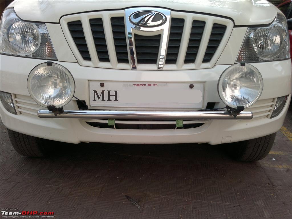

Originally Posted by pcpranav (Post 2687453)
earlier ref:
Attachment 891036
Attachment 891038
Attachment 891037
The green thing attached to brackets is just a piece of pipe/hose I have put so that sharp edge of bar doesnt hurt; temporary. The second Yellow set would be done at later stage, though provision of bracket is done. The bar is very sturdy and rock solid; heavy duty brackets stuck to the chassis. I have applied the adhesive tape on the (default red) wires so as to give black color and a layer of protection.
Connection: currently its connected to the (Front) Fog Lamp. Installation of a dedicated Switch may require opening of dashboard OR drilling - hence postponed.
Overall the light performance is good. The white covers are supplied in the pack, but I have kept them aside. Kids tend to 'align'/move them ! It is vibrating a bit on bumpy road - need to put a washer n tighten the bolts - lazy me.
regards,
Pranav
instead of what you did in pic 2 you could have done this so that the first contact point in case of minor bumps, the rod would hit first in stead of the light's glass.
hey i am not photoshop expert i just did the best i could with paint just to make a point. hope this helps you, since you put the efforts to get a fabricate a bracket and pipe for the fog lamp.
i guess you can have your fabricator do this, all he would need to do is remove the bracket welds he did now and re-weld them a little behind the pipe.:)
