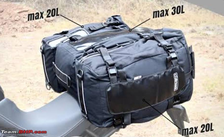

There is the option of buying a second Max 20 and combining it with option 1 to build a 70L waterproof setup
IMO Option 2 is the best option for the following reasons :-
The Saddle & Tail Bag Review Thread-screenshot_2023110123005705_40deb401b9ffe8e1df2f1cc5ba480b12.jpg
Would look something like this.
Hope this helps
70 litres that high up hanging off your side of your bike is definitely not how I would like to ride to difficult places.
Keep your existing dirt sack as a tail bag. A 30 litre tail bag is just enough weight to sit on your tail rack. I usually strap tools and food into a little 22 litre with water on the rear seat. Easier to swing a leg on as well.
Try and look for bags that sit lower on the sides like a saddle bag but bring the Center of gravity to the lower part of the bike.

This is something i would avoid:Shockked:
Three tied side by side, with all that weight & stress on straps!
The bumpy Indian roads will pull the side bags down in jerks & High stress on straps. Kind of how wings will flex under turbulence. Chances of side bags falling off or one side load shifting down once any strap breaks is high.
Luggage Setup Failure in a nowhere place is painful. As such you will be in areas with nothing around Tezpur. Take it like every load is secured inside an helicopter before takeoff. Cant risk straps breaking under turbulence.
The high CG! Such weight at one spot exactly on rear seat is too high!
We tend to justify thinking, even a pillon weighs more so this luggage set up on rear seat will Feel the same. We compare dynamics of both which are completely different. I was guilty of this comparison as well.
Then, weight mismatch on both bags attached to sides will be felt all ride long.
For this amount of weighted luggage- saddle bags+ a tail bag will be more secure, safer method to carry & less chances of strap breaking (less, not zero).
It will lower the CG to safer limit. Extremely important!
Aluminium Panniers & top box? By far the safest way (and cleanestlol:). But its a heavy setup & riding dynamics cant be learnt over night!!!! Give it few rides.
Last but not the least- possible to reduce the stuff to get in two bags? Strap two top of each other? Some items are absolute necessary for emergency even if they are never used for years. Some pure useless & fancy or carried due inexperience.
Carrying common equipment between fellow riders? or clothes washing end of day to reduce items & nothing fancy to wear!
The way i think is- am i going on a luxury tour with different fancy clothes for everyday selfies to get more Likes! Or is it an Adventure Tour.
If only this luggage setup is available- suggest take the car. Period.
~30-35kg weight of luggage in this specific set up= take the car..
Not worth risking life carrying load in this manner dangling on straps sitting high up on CG.
Or change the setup to panniers / saddle bags.
When it comes to luggage on bikes in rough terrain-
Only the Less is Blessed!
Dirtsack has essentially copied what Kriega did with their US-70 drypack. I have enough confidence in the straps and the system itself but more weight that high may be an issue. Also, I realized it might be tricky to carry extra fuel in this setup.
I think we are confusing the volumetric capacity with weight. 30 litres need not weigh 30 kgs.
Two things Sir.
Firstly, the luggage by these companies are time and field tested and not so flimsy to give way easily due to weight while moving. And I'm sure nobody will go jumping obstacles with all that luggage tied to the bike.
Secondly, as far as wing loading and consequently wing flexing are concerned, these are complex aerodynamic phenomenon and are irrelevant here. And even with that logic, the wing span to chord ratio in this case (even with the wildest imagination and consequent comparison) is negligible. Hence, not a cause to worry. :)
Luggage Setup Failure in a nowhere place is painful. Take it like every load is secured inside an helicopter before takeoff. Cant risk straps breaking under turbulence.
Cannot draw comparison between the two.
Loading and securing cargo in a helicopter is according to floor loading which again has no relevance in this context.
With that logic, nobody would use a top box also which is not the case. How one packs the luggage is upto one self. Volumetric capacity and maybe requirements are more. However, from my little experience, I can vouch that one doesn't need more than 40 litres max for a 15 day tour including camping equipment. The planning and packing skills come with experience. After the first trip one realises that almost 50% of the stuff has come back untouched.lol:
Hope that helps
# You said 70lt set up. People stuff 30kg in 70lt volume.
# We may discuss wing chord & aspect ratio in detail & discuss how wings flex under turbulence in a separate chat, like gentleman if u wish. In the wildest dreams how wings have broken.
# if lashing is as per floor loading then why strap it down as per wt of load? Again, we can discuss how lashing has broken and planes have crashed once load shifted, if u wish to discuss like a gentleman.
# Regarding the kind of luggage riders carry. Just today saw someone carry 50kg weight in three bags all on the top rack only. And he was proud of this crazy thing, and others messaging him cheering that its ok rather than just say its not good. So, guess lot more needs to be seen.
# Maybe face a falling top box because rack failed as someone over stuffed the box. People will carry every kind of weight, in every way. If one wants to be so confident then can use aerodynamics to strap luggage down.
Hope that helps!
Safe skies
