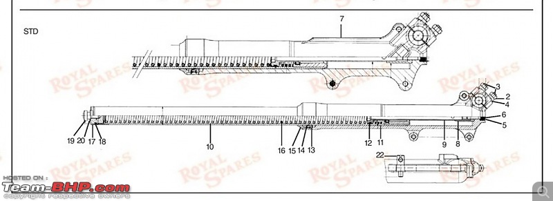

@ ArizonaJim : The fork oil change for my Standard 350 UCE is overdue. I have done 16k now where the oil change should have been done at 12k. The UCE Bible says nothing about forks and I don't want to take my bullet to RE service and get more bad than good. I was searching the forum and came across this post. My bullet has allen key nuts on top of the fork and the bottom of it. So I presume that all I have to do is drain the fork oil by opening the bottom ones and refill 195ml per fork over the top hole. Am I right here ? Do I have to pump the forks before closing the top allenbolts to remove air bubbles ? Kindly advice.
regards adrian

Because there seems to be several different front forks used by Royal Enfield I suggest you first try to remove the allen key bolt on the top of the forks. Do this before attempting to drain any oil out of the fork.
As I recall, on some of the forks, removing that top allen bolt will not open a passage to refill the fork. It will be a blind hole leading nowhere.
If this proves to be the case, you will not be able to simply drain and refill the fork.
If the top allen bolt is just a plug to allow the fork to be refilled, drain the oil and pump the forks several times to blow out any remaining oil. Then replace the plug and add the measured amount of new oil.

Thank you ArizonaJim. Have checked with several service personals as well with our famous local mechanic Mr. Murugan and they all sing in unison : "The forks have to come off the bike to drain oil". So for the time being I feel that the job is out of my league. So I have decided to take the machine to Mr.Murugan so that I can see the procedure right before my eyes and decide if it would be a DIY job next time
Warning : Do NOT pour in the entire fork oil bottle!-standard-front-forks.jpg
IF ANYONE FROM ROYAL ENFIELD IS READING THIS : "WHY ARE YOU DOING THIS TO US? A 45 MINUTE HIGH PAID JOB EVERY 12000 KMS WHERE ALL THE FRONT END OF THE MOTORCYCLE HAS TO BE STRIPPED FOR A SIMPLE FORK OIL CHANGE. WHY DON'T YOU MAKE SIMPLE FILL AND DRAIN FORKS LIKE THAT OF G5 FOR ALL BULLETS ?
OT : Is the front forks of G5 available for purchase in India and would it suit a Standard UCE 350 ?
regards adrian
