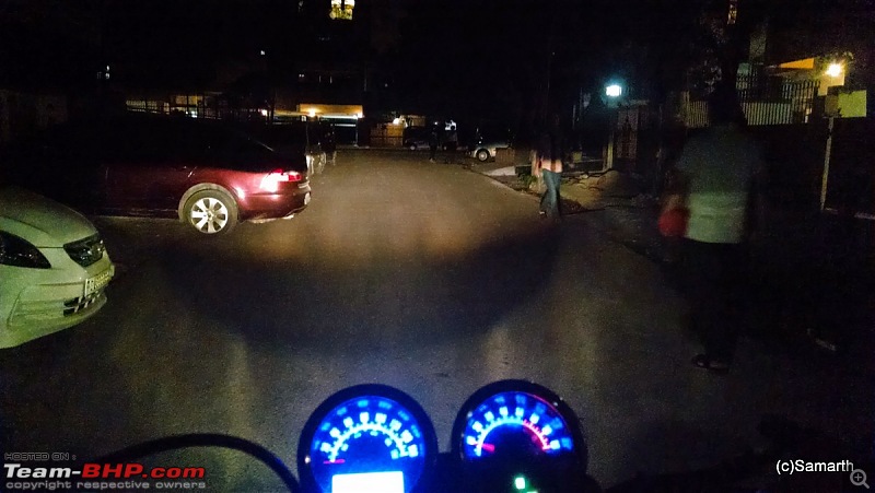

Originally Posted by akshay4587 View Post
How much did you pay for the bars?
...LED's and from where did you pick them up from?
Here are some images showing effectiveness of the LED bars.
No lights
2014 Enfield Thunderbird - My entry into the Motorcycle world. EDIT: 9000 kms update-1img_20140619_205339743.jpg
Low Beam Only
2014 Enfield Thunderbird - My entry into the Motorcycle world. EDIT: 9000 kms update-1img_20140619_205349616.jpg
High Beam Only
2014 Enfield Thunderbird - My entry into the Motorcycle world. EDIT: 9000 kms update-1img_20140619_205356946.jpg
Low beam + High beam
2014 Enfield Thunderbird - My entry into the Motorcycle world. EDIT: 9000 kms update-1img_20140619_205408938.jpg
LED bar only
2014 Enfield Thunderbird - My entry into the Motorcycle world. EDIT: 9000 kms update-1img_20140619_205422110.jpg
LED bar + Low beam
2014 Enfield Thunderbird - My entry into the Motorcycle world. EDIT: 9000 kms update-1img_20140619_205511397.jpg
And here's the link to the video: https://plus.google.com/u/1/photos/1...52975137791939
samarth.bhatia is offline   (4) Thanks

Nice throw.From where did you purchase the leds?

Based on these photos, it seems like the LED lights are lighting up even the tree and the elec. pole all the way to the top!
Did you feel that the LED's should have been installed further down to avoid hurting the oncoming traffic?
Oh, one more question: Did you need some relay or fuses to protect the wiring while installing these LEDS?

I understand what you mean about the light throw being a little bit upwards.
I've actually adjusted them to the lowest possible setting, and only a tiny fraction is getting dispersed in the upper direction. You can compare it with the image of Stock High Beam Headlamp level - you'll find that LED lights are not lighting as much of the higher patch.
Since the lamp is using only 40W of power, I have not installed a relay as these are powered from the stock ignition connection, and that can take a load of 100W easily.
I have put a fuse though, currently at 10Amps. I'm not very sure if that's the correct one to use. Any suggestions?
