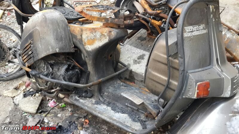

Though my Bajaj Chetak may not be old enough for being considered as a vintage scooter, it holds a vintage value for me and my family. Everyone has a deep emotional attachment with their first vehicle, the one on which they used to travel as a child.
This is the story of one such scooter.
The scooter served us well till my father bought a bike in 2001. Eventually he gave up riding the scooter due to back pain. He then decided to sell it rather than leaving it to bite the dust. We were offered Rs 10000 (which was a great deal at that time) by the mechanic who used to work on it. But selling the scooter was totally unacceptable for me and my sister. It was priceless for us. And when the mechanic guy arrived, we couldn't resist our tears and insisted on keeping it with us. At last, Dad decided not to sell the scooter.
The scooter was left untouched in the porch for few months and then moved to backyard of our house. Even though the fuel tank was emptied and oil was poured in the cylinder, the engine was stuck when we tried to fire her up in 2006. With the help of a local mechanic, we managed to start her up. It was badly in need of an engine rebuild, as the engine produced so much rattling. And it took yet another 6 years to start the much needed engine rebuild.
