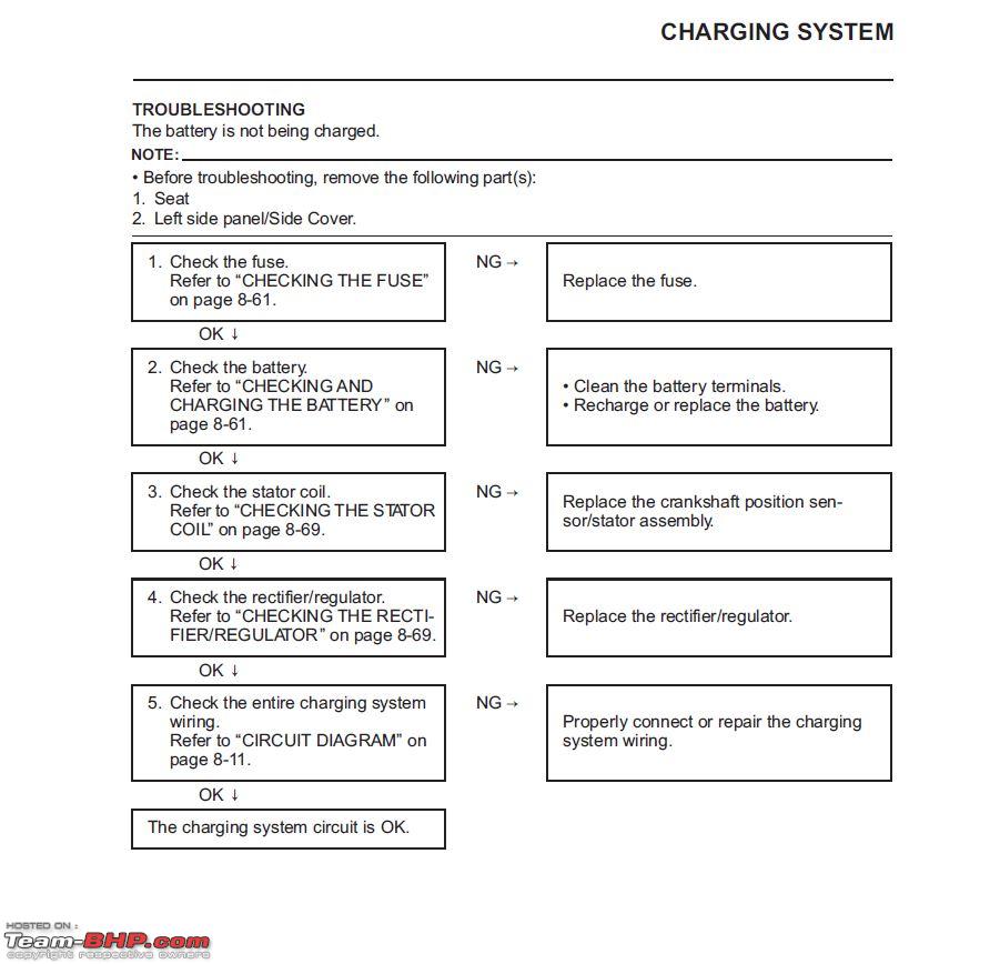

Hi,
I found this in the R15 service manual.
Should definitely help.

Originally Posted by ashwin.terminat View Post
Hi,
Attachment 1403576
Attachment 1403580
Attachment 1403581
Ashwin you are a life saver, thank you so much. This is exactly what my mechanic was saying. Yes I tried to look into owners manual, which I did not because it was not the service manual. Thank you once again brother.Can you provide me the link from where I can download the service manual?

Could not do any work on the bike, as was busy with office work. Tomorrow being off will go ahead and remove the side panel, check the fuse and clean the contact points of the wire terminals. Also would check the wiring for any fault. Have told my mechanic to arrange for a regulator to check if that is the main culprit. But yeah today tried to start the bike, their is no display and no sound of FI coming ON, so I think tomorrow the first thing would be that I have to give the battery for charging before I start opening the bike. Will update with progress.

I got the new Regulator and then started opening the left rear panel behind which the Regulator is fixed. In the meantime I noticed that my New Battery has gone dead completely, so gave it for charging. I changed the Regulator and then got the Bike started and it came into life in one self. After that I took her for a small ride locally where I went to ride in neck to neck traffic as I wanted the heat sensor to activate the radiator fan and then check for any warning sign, but good no warning came up.
