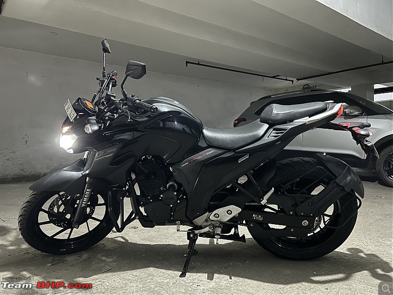

Turns 7 with only 10,200 km on the Odo.
In the last year, the running was really low. It was hardly 1,000 km.
In between I wanted to practice a bit of detailing. So I decided to try it on the FZ25 because of its smaller surface area!
Washed and applied 3M shampoo to clean it. Followed by a proper claying. Then the Turtle wax was applied. The end result was satisfactory considering it was my first try.
Yamaha FZ25 : An Owner's Point of View-img_0575.jpg
Yamaha FZ25 : An Owner's Point of View-img_0576.jpg
Yamaha FZ25 : An Owner's Point of View-img_0577.jpg
The black edition garage!
Yamaha FZ25 : An Owner's Point of View-img_0580.jpg
The whole process took more than a couple of hours and on day one itself, I realized this was not my cup of tea! Let the professionals do their job! It's too hectic and time-consuming, especially for people like me who suffer from OCD!
