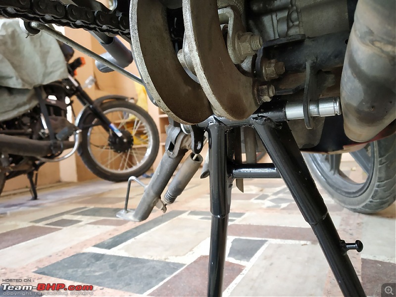

The main stand costed 350 (local but very good gauge) and the stand shaft pin another Rs. 68.
R15 Center Stand (improvised hack) - A cheap mod instead of a paddock stand-shaft-pin.jpg
The shaft pin/stand Inserted (Reference only).
R15 Center Stand (improvised hack) - A cheap mod instead of a paddock stand-shaft-pin-stand.jpg
This is how the pin is inserted on the chassis of the bike. We have a hanging earhole-ish protrusion under the bike. This is where the stand shaft/pin is to be inserted.
R15 Center Stand (improvised hack) - A cheap mod instead of a paddock stand-how-its-inserted.jpg

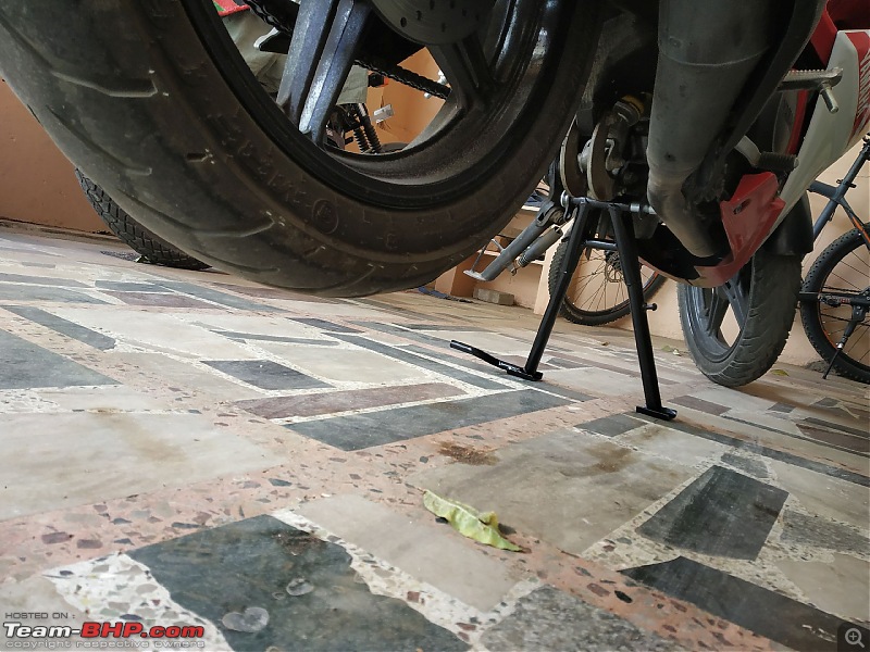

Here's a view underneath. Notice the height.
R15 Center Stand (improvised hack) - A cheap mod instead of a paddock stand-height-view.jpg

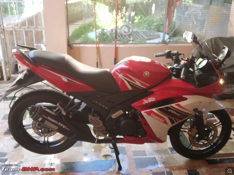

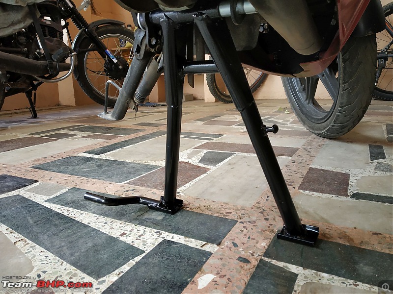

Here's the overall deck height of the bike with the stand on. In real life, it's even more taller than it visually is on the picture. One happy man, and extremely pleased with the outcome.
R15 Center Stand (improvised hack) - A cheap mod instead of a paddock stand-deck-height-1.jpg
R15 Center Stand (improvised hack) - A cheap mod instead of a paddock stand-deck-height-2.jpg
