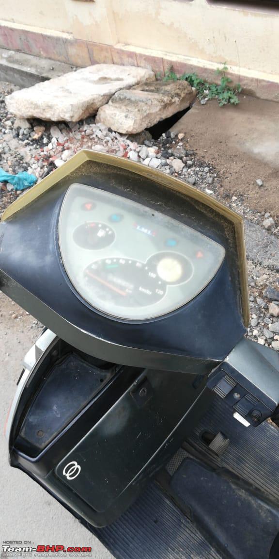

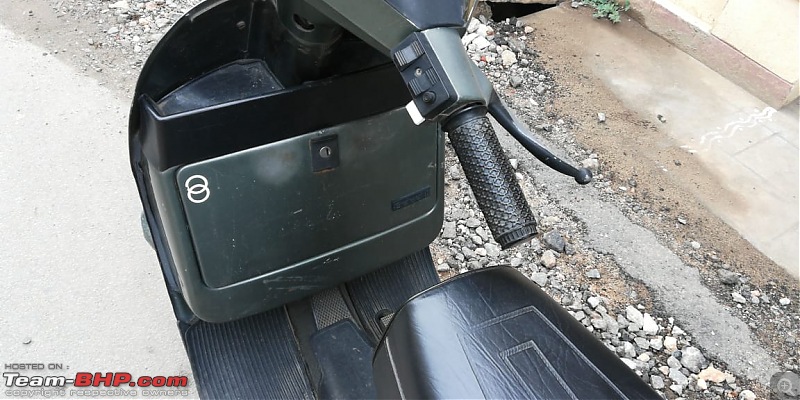

Here are few pics on the day it was picked up. Thanks to the Amirdesh and Sarvesh. There are the folks who helped me in closing the deal and shipping the scooter to Chennai.

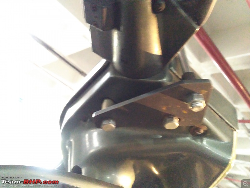

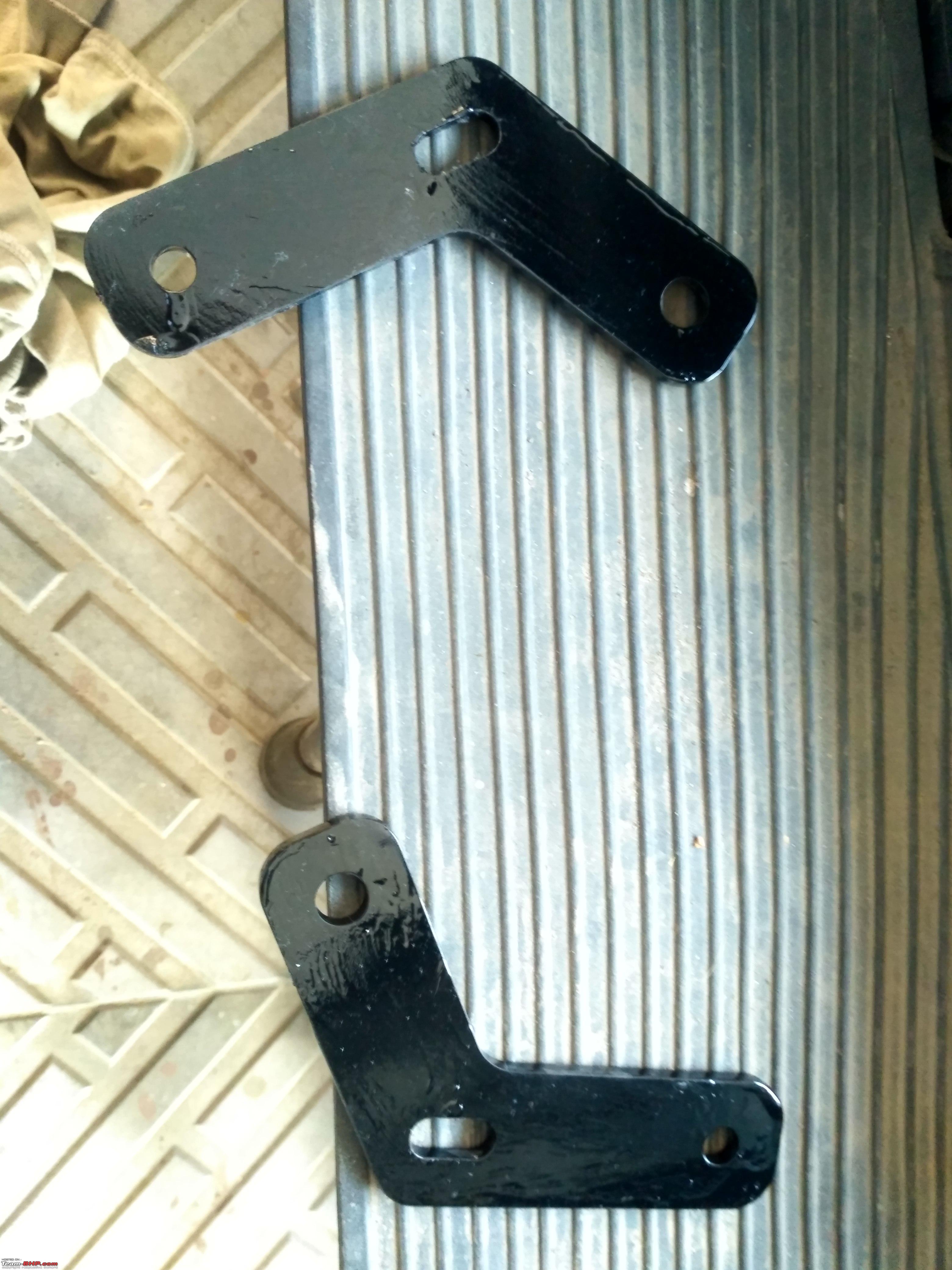

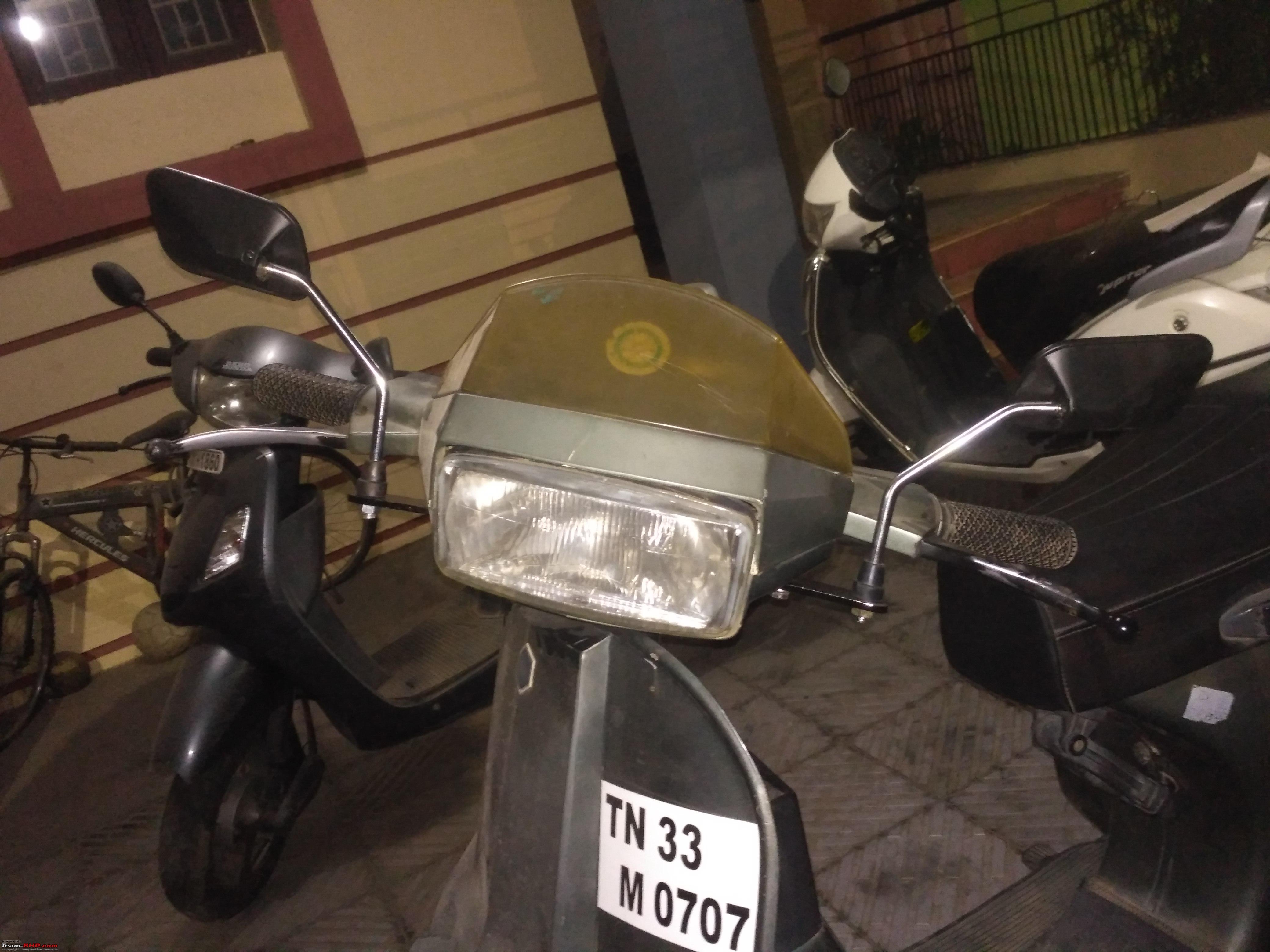

As seen in previous post, the scooter didn't come with side mirrors nor did have the brackets for mounting them. Guess, previous owner had them removed. As for any other body part, this bracket was also different from the Bajaj Chetak or LML Nv150. And hence I wasn't able to use the Chetak mirror clamp which was available for Rs20 at a shop near by. So I have to Do it Myself.
With he help of my colleague who had a good contact with a laser cutting centre I got a mirror clamp done. As I had seen the handlebar and mirror vibrate a lot in Bajaj and LML scooters I just wanted to keep the clamp short and heavier than factory specs. It looked more like a triangle. However the short length was suitable for the mirrors I had bought. So once again did some design changes and got another pair made from him. And now things are in place. The mirror is positioned correctly and I could driver safer.
Installed the side mirrors of Suzuki Max 100R. Also thanks to Karthik Makam (Funkykar) for helping me with a new speedometer from Bangalore.

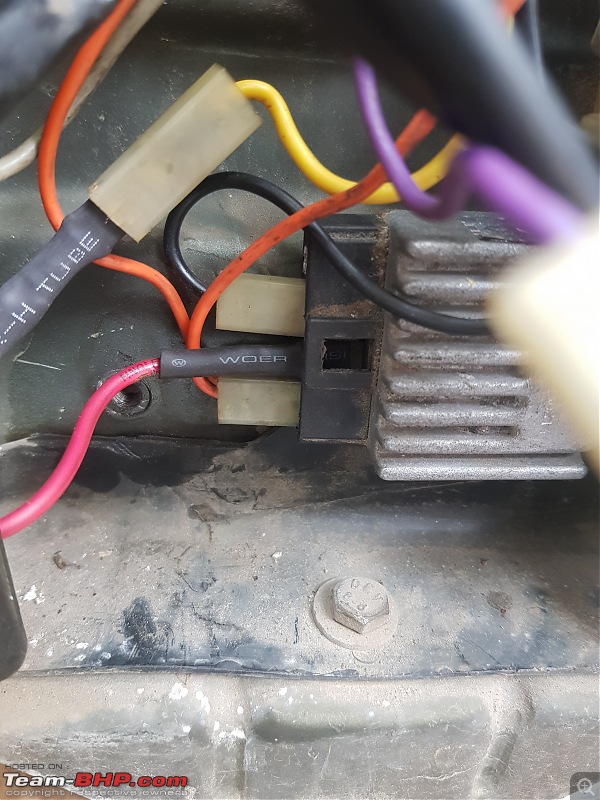

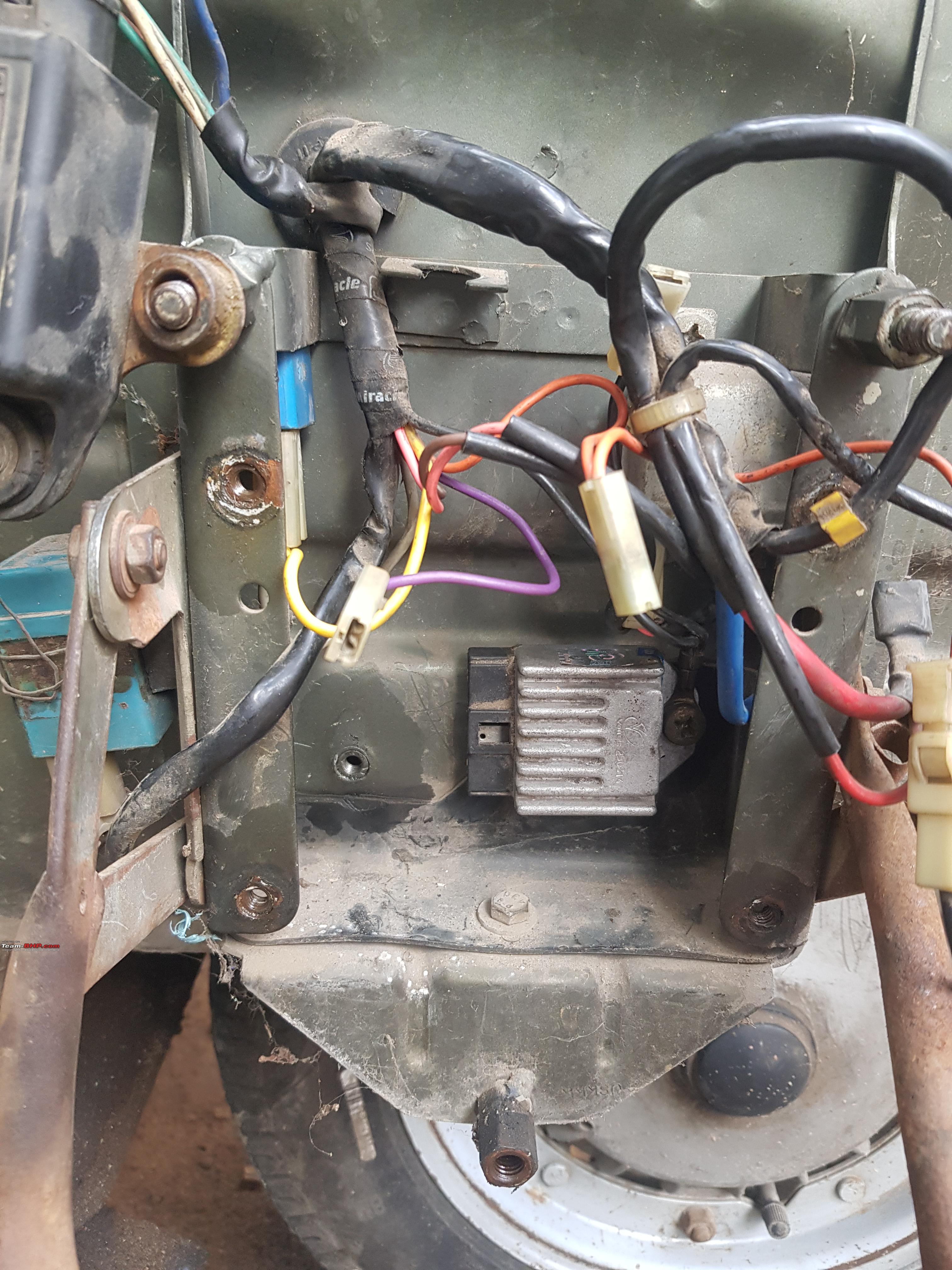

My year 2000 LML select 2. Original RR unit didn't charge the battery. AC side was OK.
Bought a replacement part online. AC side output voltage was too low and lights were too dim. Couldn't take the scooter out in the evenings.
Bought one more. This time the AC and DC voltages were good, but there was an internal short that made the horn and self start work even without the key.
Gave on the 5 pin rr units and resorted to isolate the AC and DC regulation.
For the AC side I installed a 3 pin bajaj scooter AC regulator. And for DC side I used the old pulsar 4pin RR unit but wired only for battery charging. Took care not to cut and of the factory wiring harness.
Now all work fine and peace of mnd restored.
