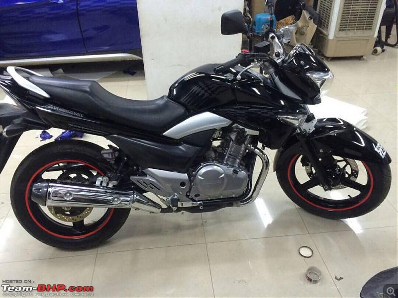

Hello All, Been reading on this thread about OEM's ditching the center stands. I got a Suzuki Inazuma and I'm having a really tough time for the chain lubrication and other maintenance. I'm the 2nd owner and purchased the bike when it was 2000Kms on the ODO and now I've clocked 7000Kms in total since 2015. The center stand was an accessory which the previous owner did not install. I contacted the ASC - Shiv Suzuki, Chinchwad, Pune for the center stand, they mentioned that the part is not available and cannot be made available.
Have contacted a friend in Tokyo for the same. He is trying to locate an after market part. The Genuine Part costed around Rs.10,000/- in India and the Genuine Part in Tokyo costs around Rs. 25,000/- totally un-affordable for me at this point of time, hence looking out for an aftermarket stand.
Any lead on this would be much appreciated.
A total slam on the face by the manufacturers to their customers for ditching the center stand!
A pic of the Black Beauty below
Center Stand: Why are new bikes ditching it?-03.jpeg
