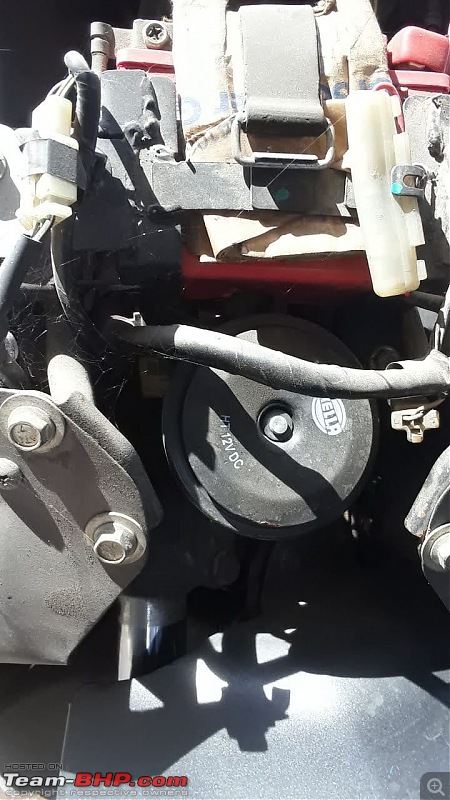

Originally Posted by sameerpatel90 View Post
riding past a few meters I felt the scooter was pulling one side and difficult to maneuver in the turns or changing lanes.
I think the potholes caused it in my case too. But was yours a constant pull or did it vanish after some time ?
Agree the suspension does seem a bit fragile but don't know how other telescopic scooters are doing.
Thanks for the pics.
