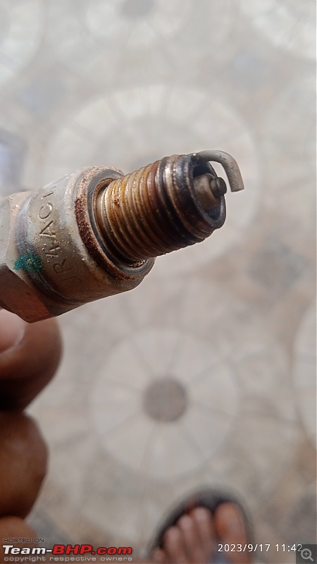

A new update on the ownership experience.
Since the last few months, the bike has struggled to start on cold mornings and idling is erratic, with occasional check engine light switching on. Things got worse as my bike usage has now increased to 300kms a week, all thanks to the hybrid working arrangement at the office.
Switched back to 10W30 instead of 20w40
Charged battery
Cleaned air filter
Removed the TPS & IAC solenoid, cleaned and refit them
Drained the float bowl
Cleaned spark plugs
None of this helped to sort the idling & starting issues
Finally got the OBD scanned at a local garage, and they said "ECU is dead", I doubted his BS6 skills and tried another garage, here they found TPS to be dead.
I got fed up, and took it to my trusted relative's garage in Kolar, he had the bike for one day and figured out the root cause.
The TPS on Bajaj ECarburator has a setting called, IPS - Idle Position Setting. This needs to read 14% or more, in mine it was reading less.
They loosened the TPS and refit it slightly to the right, the TPS has a single bolt fitting setup, and the hole on the TPS is oval to allow us to adjust this particular setting.
Finally, one last ECM scan and clear codes are done. All thanks to Shekar Automobiles, Gowripete, Kolar. Since he has all the experience and the right tools, ECM scanner, code eraser, ignition coil testing equipment etc. things were smooth.
The return trip was in absolute rain and bliss to push the bike to 80+kmph on multiple occasions. The bike is super responsive between 70-90kmph. Although not a fan of riding fast, finally finding the almost new crisp throttle response was nice.
