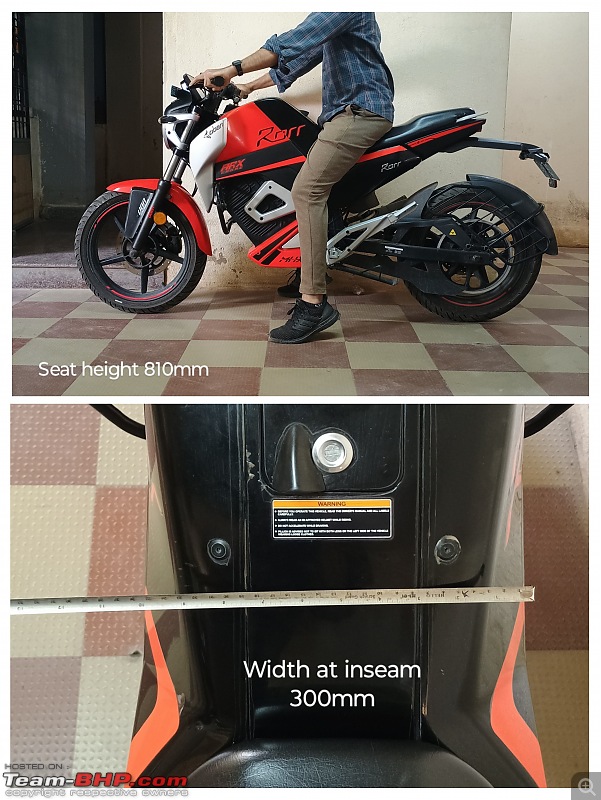

Ergonomics:
* Both brakes are on the handlebar however, the brake lever reach is very far and non-adjustable - so couldn't use it effectively
* Hugging the tank is a must to prevent sliding back and forth but the squared off 'box' profile does not facilitate it.
* A week of riding caused a pain in the inner thigh region.
* Seat and central portion is really wide so reach to the ground is hampered.(I'm 5'9 and cannot flat foot)
* Handlebar position is too low.
* Hip, knee position is too high.
* Accidentally reached out to rear foot brake more than once
* Seat cover is very slippery - seat base is wide but cushion is flat and thin

My good friend rode the bike and this was his comment:
" Seat height too high. I'm at median height and if it can't cater to me it's definitely not good imo."
"I felt the ride stance to be ok, probably because of the changes made"
