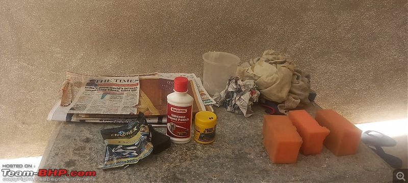

Materials Required :
DIY: Compounding and wax polishing the Hero Honda Street!-materilas-needed.jpeg
Any Shampoo (Head and shoulders works good though)
Moto Max 2k Rubbing compound
DIY: Compounding and wax polishing the Hero Honda Street!-motomax-compound.jpeg
Waxpol Silicone Liquid Wax Polish
A few sponges
Dashboard polish Moto Max
Old waste clothes

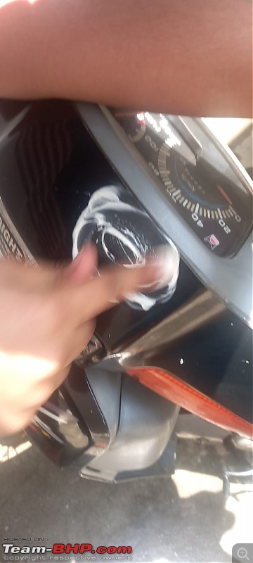

After polishing the dashboard, making sure that the vehicle is fully dry, take some compound in your fingers and apply it in circles on the panel :
DIY: Compounding and wax polishing the Hero Honda Street!-applying-compound.jpeg
Don’t forget to remove the compound using a waste cloth by rubbing the compound evenly and spreading it on the panel in circles until it completely disappears.
