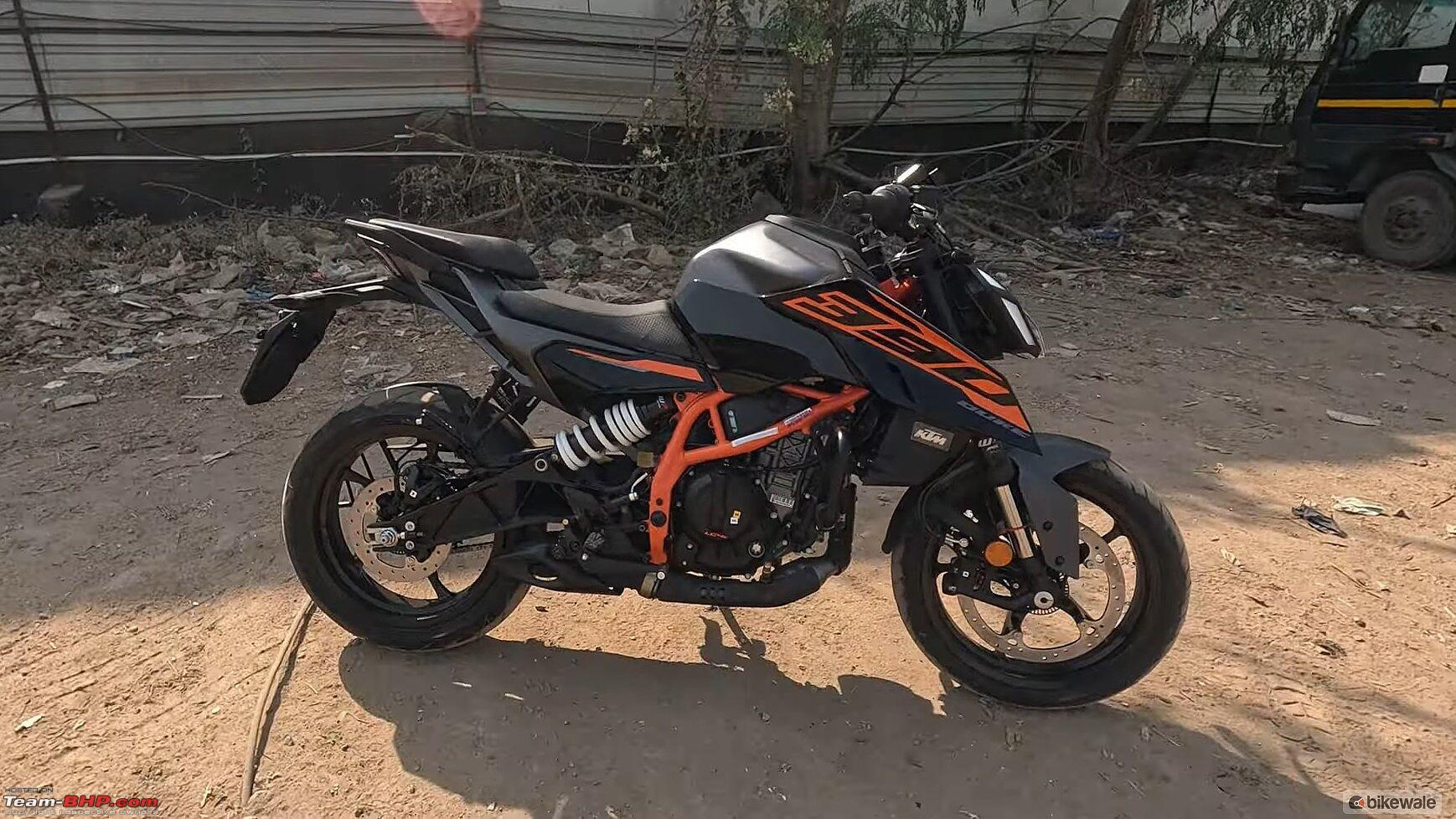

I visited the KTM showroom to check out the new KTM Duke 390 in black. The color looks much better in person and is a great option for those who prefer a more subtle look over louder shades.
The black variant came with Metzeler tires, whereas the other colors with cruise control had Apollos. The SA wasn’t sure why there was this difference.
