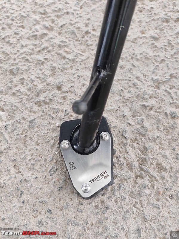

SIDE STAND EXTENDER:
Another product from Zana, and seems like decent quality.
