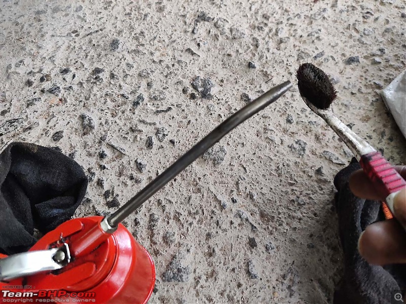

I use a simple device to lift the rear tyre of the bike to clean and lube the chain. There are many similar products available in market like snap-jack. But what i have a simple home made device which does the job.
I use an allen key to get a leverage point on the bike.
Insert the home-made snap-jack as shown in the picture.
Press it to get the wheel off the ground just enough for free rotation. The
Clean the chain nicely.
I use a brush and thick gear oil to lube the chain. Been doing so for many years. Earlier I used expensive spray cans etc, but have seen no big difference in longevity or quality. Gear oil works just fine. Trick it to use it lightly with a brush and not splash it generously. Repeat chain cleaning and lubing every 400-500 kms or more frequently during monsoons.
NOTE: Before lifting the wheel using any of these snap-jack type devices, always use a piece of band, thread, lace etc to tie the front brake lever to keep it in locked position. This will prevent from the bike from accidently rolling off while on the jack.
@nasirkaka Thanks for the tip to use an allen key! I had all sorts of difficulty trying to lift the bike (Speed 400) using the side jack on the bike's swing arm.
I also used too much Motul gear oil (a ketchup dispenser with a too large nozzle because I couldn't find another tool to oil it on a Sunday) and the bike started smoking like it was on fire in a short run, as the oil splatter on the exhaust and engine started to burn. Had to splash water on it to subside. Phew.
I should have used a brush to oil the chain like I had thought initially.
