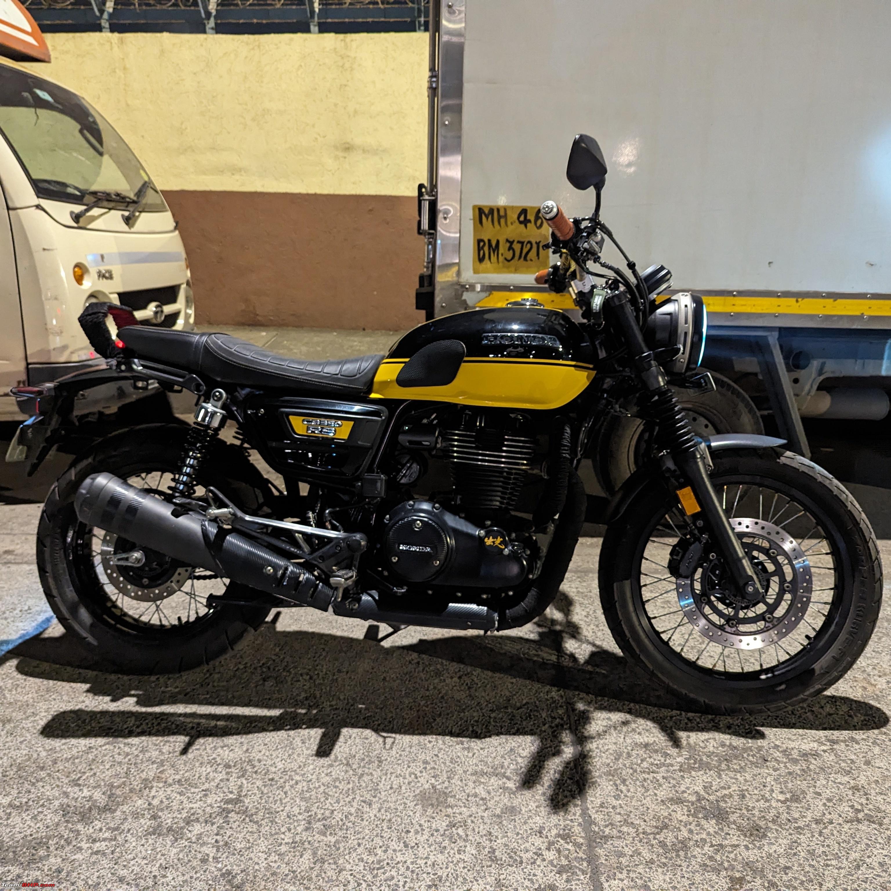

I have had my Honda CB350RS since Aug 2022. I have done 5k odd km since I got it. I use it to commute to work most days and do some weekend riding around Mumbai. I haven't done any long distance rides.
The lack of accessories for the Honda CB350RS can be frustrating. I tried my hand at modifying it with whatever I could find.
The result:
My Honda CB350 RS Review | With aesthetic & functional mods-pxl_20240115_08560751201.jpeg
My Honda CB350 RS Review | With aesthetic & functional mods-pxl_20240111_16104230701.jpeg
Modifications done:
-Performance air filter NGage Performace Parts
-Vesrah Ceramic brake pads (front and back)
-Dismotech tubeless spoked rims (the tubeless bit was a joke. I had to install CEAT tubes)
-Replaced the Handlebar and weights from Honda
-Handlebar risers from Carbon Racing
-Silencer Wrap
-Rear view Mirrors from a Honda CBR300
-Bracebar
-Bracebar Pad (incoming leather bracebar pad from Saharaseats)
-Leather Handlebar wraps
-Grabrail for pillion HTExhausts covered with a rope
Pending work:
-Braided Brake cables/lines
-Modfying the pillion grab rail to make it more aesthetically appealing (going to cut a Honda Hness grab rail from Honda ASC and weld it to the HTexhaust mounting I have right now)
-Tail Tidy kit
abhishek272010 is offline   (4) Thanks

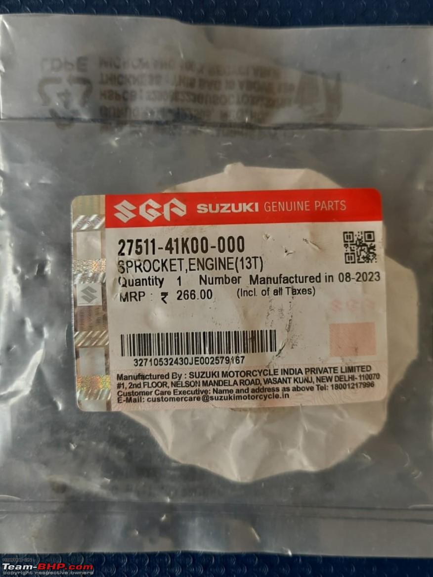

Approach 1:
A Mumbai based CB rider shared on Facebook that he used the front sprocket of Suzuki Gixxer 250 which is 13T. It was not a direct fit as it does not have the screw holes of OEM sprocket and he had to use two 24mm outer circlips and a 25mm big dollar washer to lock the sprocket into place. According to the rider the jugaad works fine and he has been using this setup for quite some time. The Suzuki sprocket costed just Rs.270 therefore I decided to give this jugaad a shot.
My Honda CB350 RS Review | With aesthetic & functional mods-whatsapp-image-20240410-11.57.34-am.jpeg
My Honda CB350 RS Review | With aesthetic & functional mods-whatsapp-image-20240410-11.57.43-am.jpeg
The Suzuki sprocket does not have the OEM specification screw holes and thus cannot be screwed into place, uses circlips and washers to lock into place
My mechanic warned me during installation itself that fitting a sprocket this way could be very risky since it is a part that receives significant torque. I contacted the rider who had done this mod and he assured me that it should work fine. Used the washers and spacers to lock the sprocket into place. The mod worked and the desired gearing changes were observed. However under high revs there was a loud and noticeable clatter from the front sprocket area. Also the gear shifting felt completely crude with the gear shifts requiring a lot of effort to slot into place. Overall even though the jugaad worked and the low end torque issue was solved, it didn't feel like a refined and permanent fix and there was always a fear that it would all break and come loose anytime.
