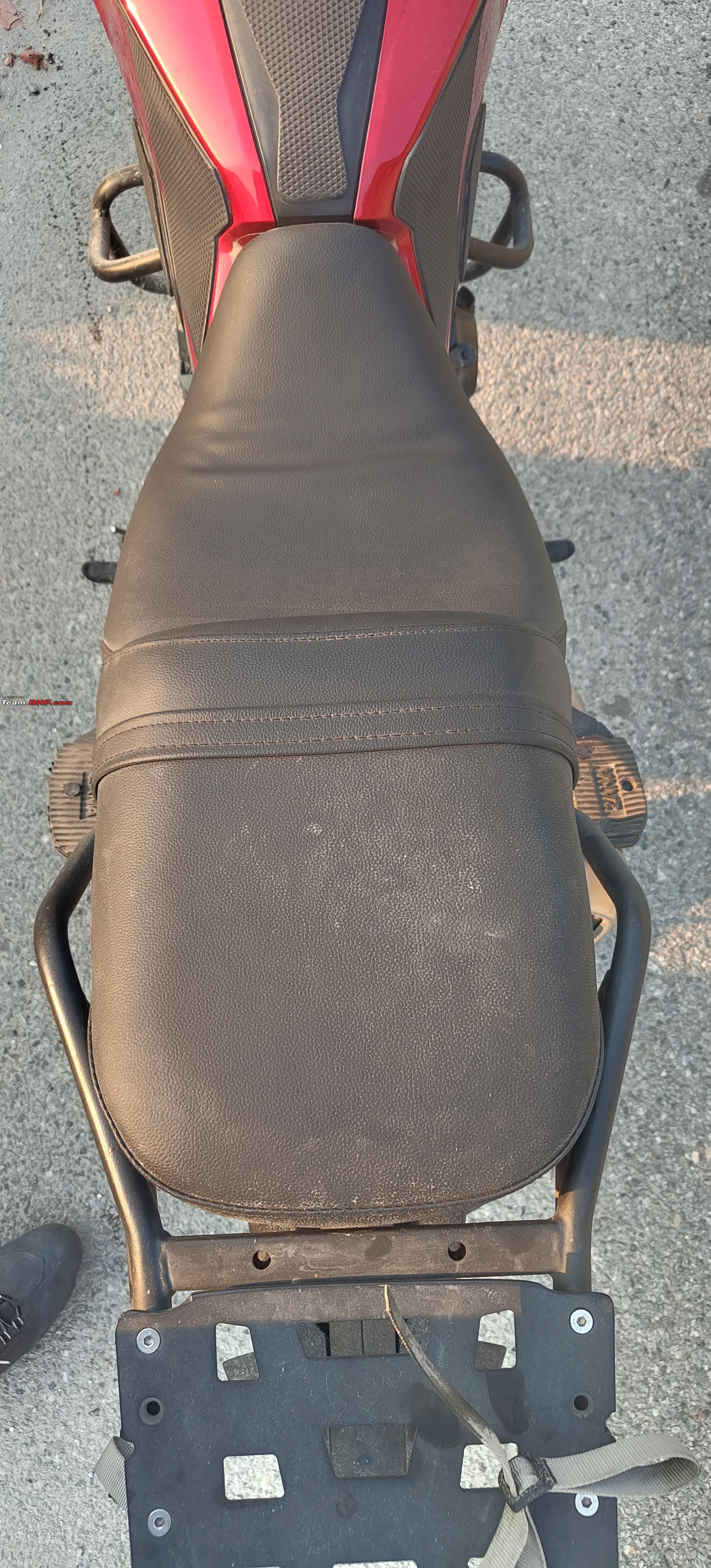

7) Realising after a few 4-5 hour rides that the CB was nowhere near the touring comfort of the FZ-S, I just went gung-ho on the internet searching for solutions. Tragically, there was not a single solution in sight, except the $650 (>₹50,000! ) Corbin seats, which are not available in India (add to that customs, taxes etc. if you are willing to import). Moreover, the long distance comfort review on the Corbin seats is bad!
8) The Zana handlebar risers had done a bit to ease the overall shoulder and palm fatigue over long distances (which wasn't overly concerning, but was useful nonetheless), but the bum and back fatigue was proving to be the Achilles' heel. Air seats weren't doing the trick.
9) Two fortuitous conversations, one with one of the BigWing (Dehradun) mechanics and another with my regular customizer, gave me the idea that I could perhaps ask some 'seatwala' to have a look. A Google search convinced me that if there was one place that could have a solution, it was a shop called Munna Lal and Sons in Chakrata Road, Dehradun. The limited reviews were all excellent, and motorcyclists raved about how good a job they had done. The reviews seemed genuine and I paid a visit.
10) Initially they thought I just needed a soft foam, but on hearing the touring aspect, suggested a hard adv style base foam with another layer of soft foam on top. I told them as clearly as I could what I wanted exactly, i.e., the shape, seat height (which I did not want to change much as it was quite comfy anyway, especially with the risers installed).
11) The guys at Munna Lal were amazing not only with their expertise and work, but were willing to themselves give useful suggestions. Once the framework of the hard foam was ready, it was pasted on to the nearly non-existent stock seat padding. They were more than happy to insist on me taking repeated test rides until the optimum ergonomics were established to my liking. It took around 4-5 rounds of test rides and consequent shaving off of the foam to get to what felt like a decent enough sweet spot, albeit with a little rise in the seat height, which is, of course inevitable with the addition of all the foam. It was to a point where I could nearly flat foot. Their cooperation during the entire process was just exemplary.
12) This was finished off with a half-inch layer of soft foam pasted on top of the hard foam.
13) The final layer consists of the seat cover which was hand-stitched with great dexterity in a few minutes, which they claimed came with "guaranteed waterproofing". They worked even beyond their regular shop hours and never pressurized me to hurry on my decision.
14) The pillion seat was also modified the same way, in addition to removing the incline of the seat and making it flat, the overall dimensions of the seat were also increased. It was fine for my wife for the short ride back home, but is to be tested over long hours.
15) Completed a ~280 km ride through mostly twisties, and I can finally say, at least for solo touring, the issue is superbly sorted. 280 km in this terrain can be translated to roughly around 450-500 km through highways in the plains. Total ride duration was around 7 hours, and all I had was what I consider very normal soreness.

18) THE PRICE: The entire seat customization process cost me ₹1,200/- (Rupees Twelve hundred, I haven't missed any zeroes) in total. This includes (for both rider and pillion seats) hard foams, soft foams, seat covers and the labour cost. I am quite in disbelief as to what a miraculously good job this small, innocuous shop has done.

I have attached a few images for reference.

23) I have invested quite a bit into accessorizing the bike, and here's a list of the accessories installed:
Hi, where did you buy the tank side-grips from? I'm unable to find them on any Indian online store. The ones available on global stores might not be worth it considering the import duties.

Hey @t3rm1n80r, bought the tank grips from Flipkart. Here's the link: https://dl.flipkart.com/s/wECNNzNNNN
