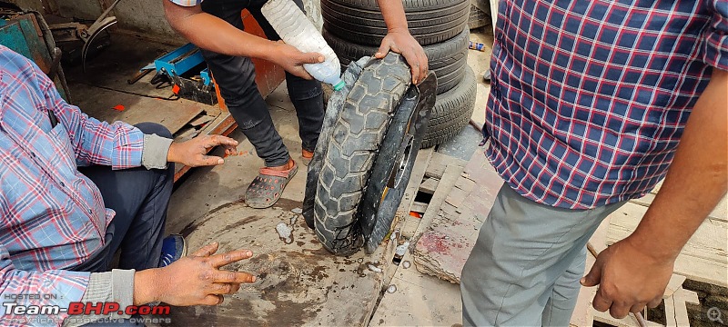

The tyre being removed:
Tubeless conversion using TUBE FLAP technique on my Royal Enfield Himalayan 450-r1.0.jpeg

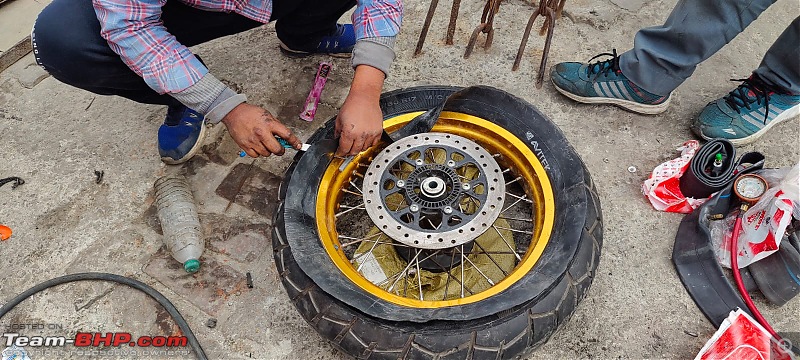

The tube is carefully cut at the center
Tubeless conversion using TUBE FLAP technique on my Royal Enfield Himalayan 450-r1.2.jpeg
The cut tube is made into a flap that covers the rim
Tubeless conversion using TUBE FLAP technique on my Royal Enfield Himalayan 450-r1.3.jpeg

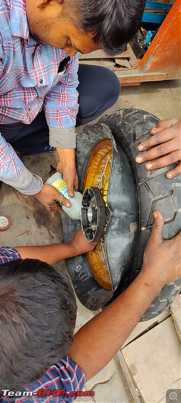

The tube is lubricated with shampoo/tire solution
Tubeless conversion using TUBE FLAP technique on my Royal Enfield Himalayan 450-r1.4.jpeg
The tire is now being put over this flap, ensuring that a portion of the flap juts out.
Tubeless conversion using TUBE FLAP technique on my Royal Enfield Himalayan 450-r1.5.jpeg
This is the most complex part and the one where the skills of the person come into play. You use the iron tire lever incorrectly and it can damage the tube flap.
Tubeless conversion using TUBE FLAP technique on my Royal Enfield Himalayan 450-r1.6.jpeg

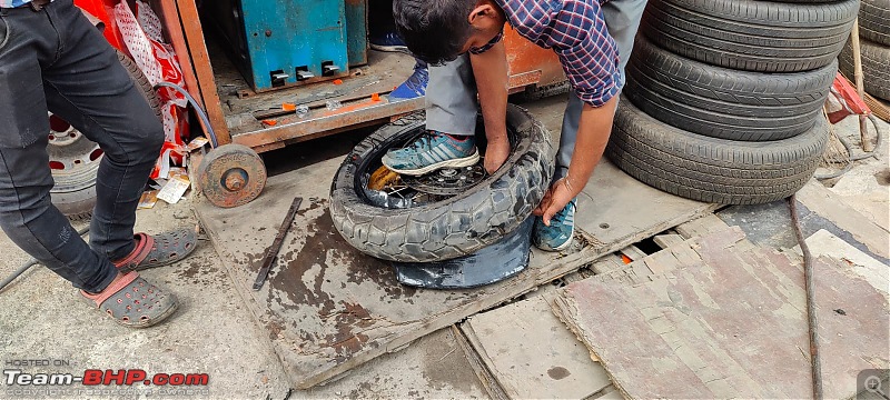

Eventually, the tire is on the rim...
Tubeless conversion using TUBE FLAP technique on my Royal Enfield Himalayan 450-r1.7.jpeg
...and the flap juts out on both sides.
Tubeless conversion using TUBE FLAP technique on my Royal Enfield Himalayan 450-r1.80.jpeg
