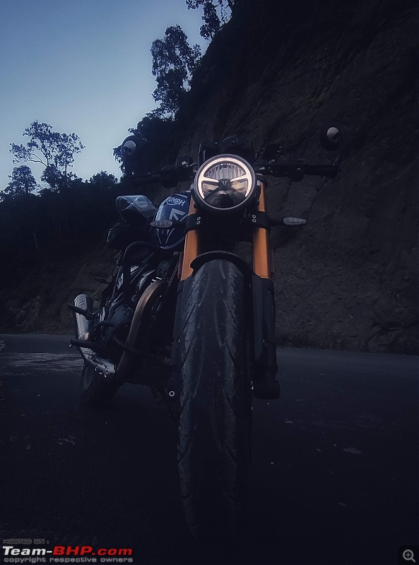

UPDATE: I rode another 100 km on mountain roads and some highways with a pillion and I can't explain how amazing the suspension is. Super stable on higher speeds and eats potholes like breakfast. The feeling changes as soon as the pillion gets off the bike, however.
I would do anything to have this feeling when riding solo. Hopefully Zelding or someone figures something out and offers a kit some day. Fingers crossed!
My mom says --- Get married to sort your solo riding issues with the motorcycle. Haha!
