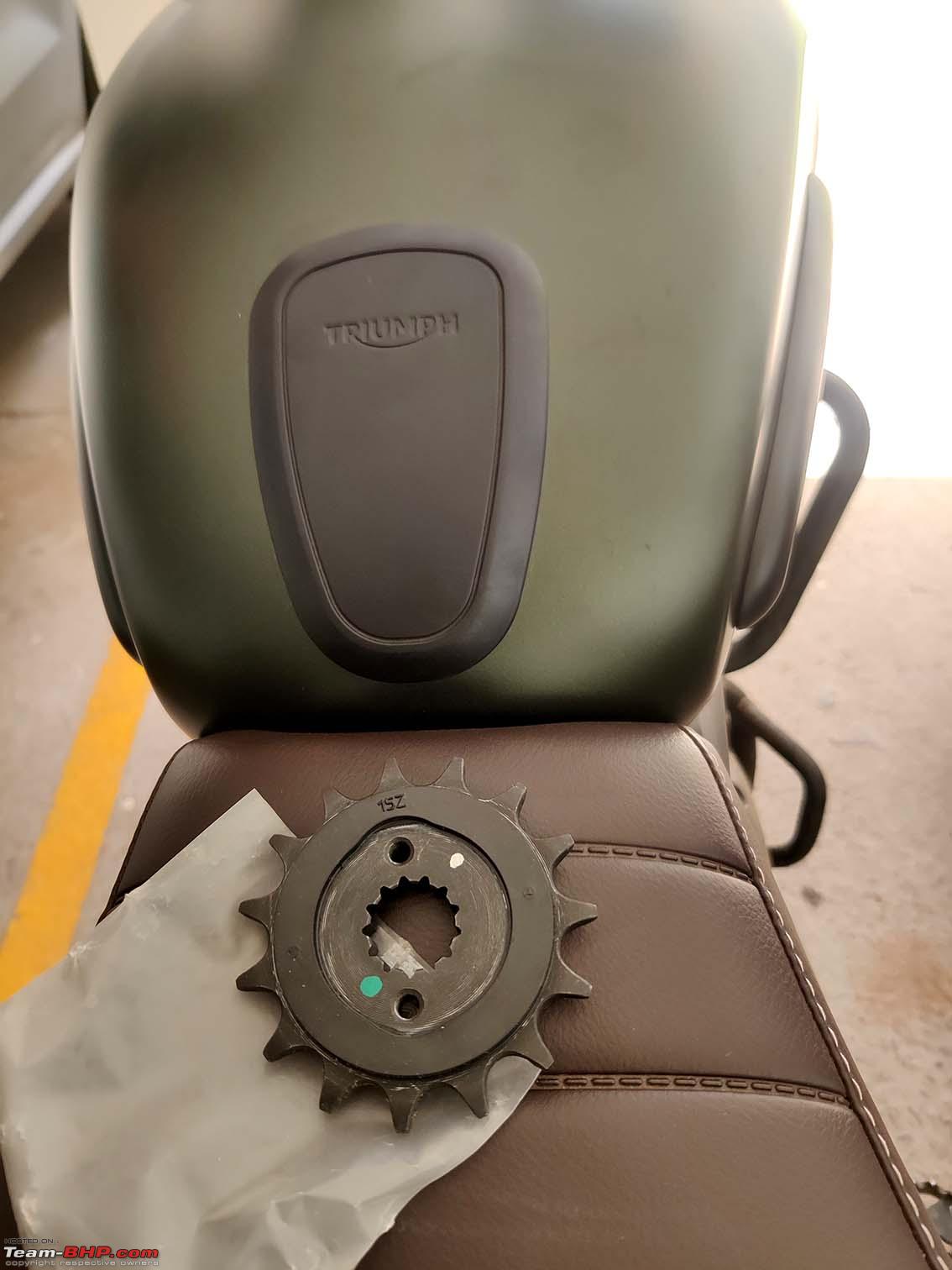

Last Saturday I met another BHPian Redliner at Indiranagar, Bangalore. He rides a 390ADV and is well versed with the Bajaj / KTM service center which is on 17th Main. He has also experimented with various sprockets on his 390Adv and knows the service team there. With his PR skills and charm, we managed to get a 15T sprocket for KTM 390. May be you can try there next time to source one. They only cost Rs. 270.
Spent the better half of yesterday trying to swap the sprocket. Being Sunday, most garages would be closed. I had seen some videos of sprocket swap on YouTube and it appeared simple enough to self attempt. I had big size Hex sockets too (24mm for wheel and 27mm for sprocket nut). So thought to attempt this as DIY, only to later realise that it was not as simple as it appeared in the videos.
