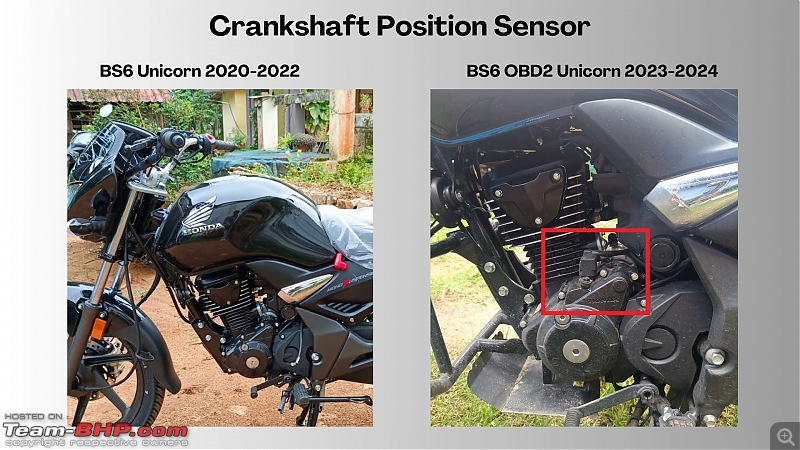

2. Crankshaft Position Sensor
A detachable CKP sensor is added in BS6 OBD2 Unicorn.
2023 Honda Unicorn Review BS6 OBD2 & Problems Faced-crank-position-sensor.jpg

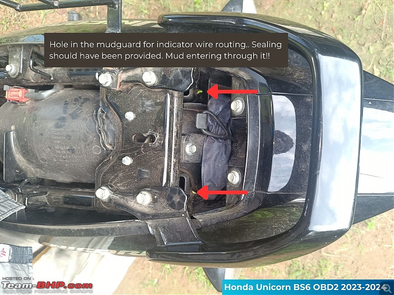

Design Flaws in Honda Unicorn BS6 OBD2 E20 2023-2024 models.
Design Flaw 1: First generation to 2024 model
Design Flaw 2: 2020-2024 models
