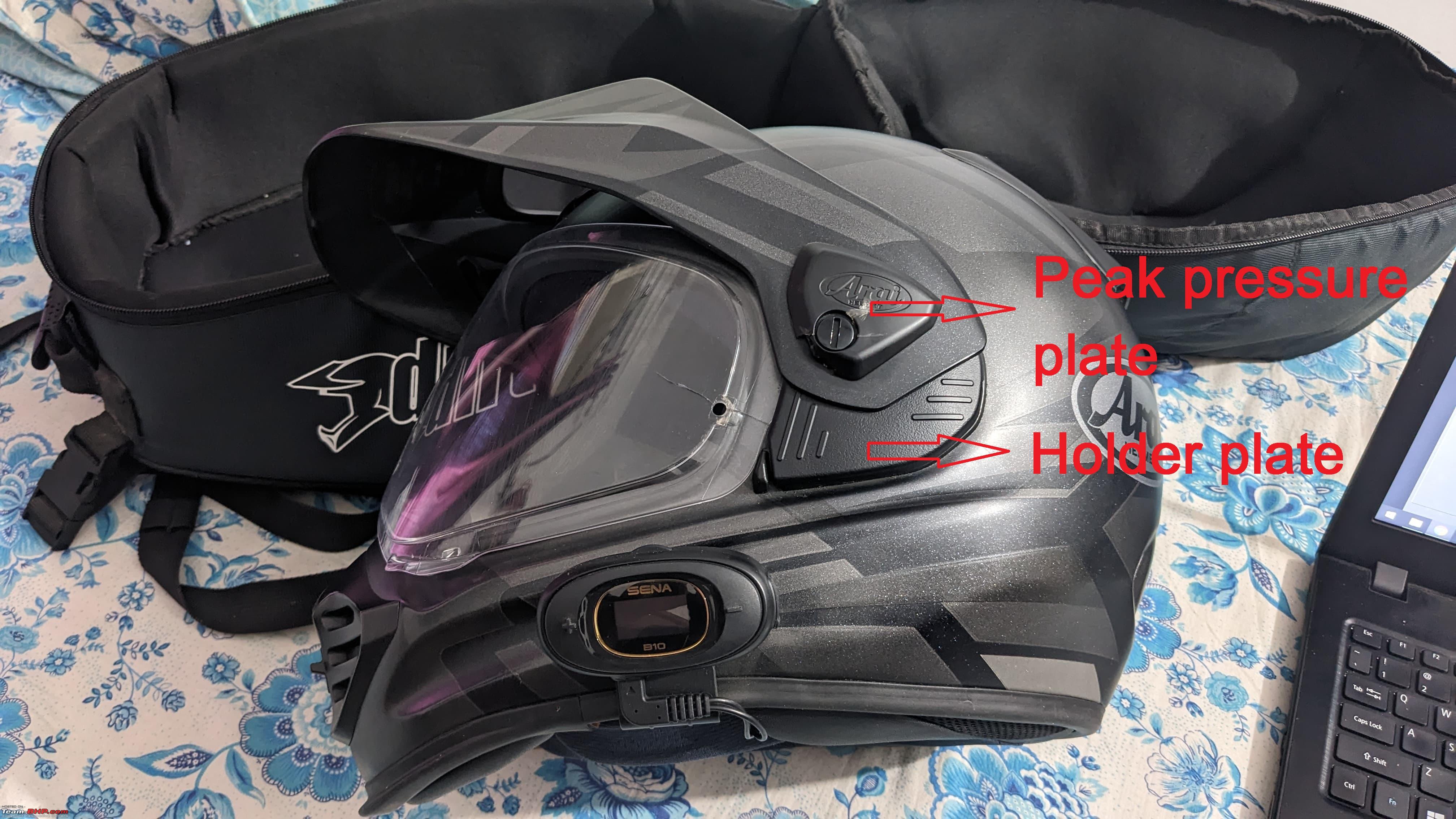

The peak pressure plate and the holder
The small, triangular plate is called the peak pressure plate. The screws can be loosened to adjust the peak. The broader plate on which this triangular plate is mounted is called the holder. It has push button which releases the holder from the helmet and the visor can then come off.

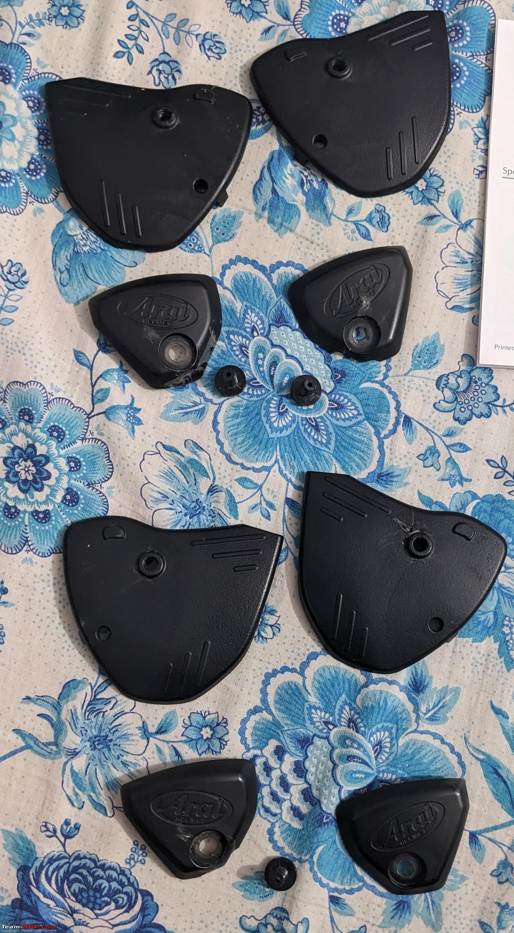

(1) February 2025 – I noticed that the left peak pressure plate was cracked and the screw, too, had started to break. I took out the plate, glued it with feviquick temporarily and ordered a new set of these plates.
(2) When I went to install this new set, I saw that the left holder, too, had cracks in it. I ordered a new set and replaced them.

The plates on the top are the new ones.

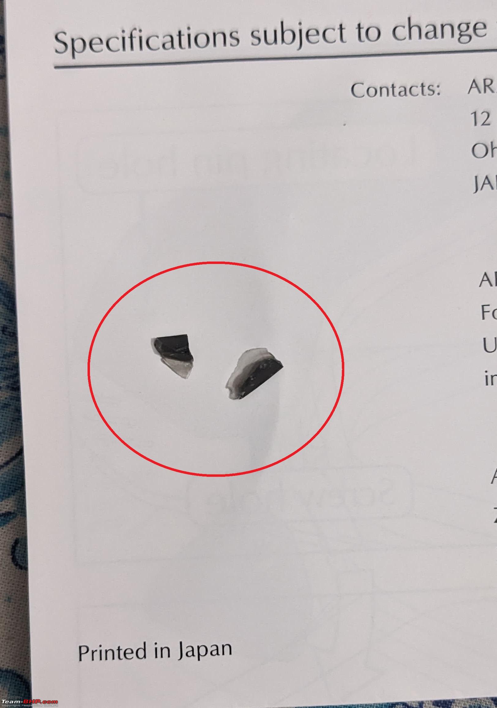

Every time I open up the helmet to clean, I find broken pieces like this.

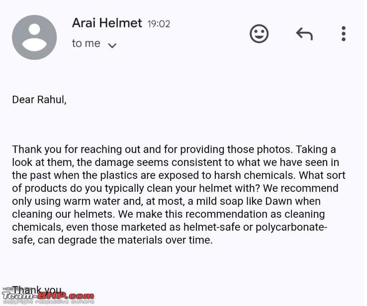

(3) As if on cue, ARAI USA sent a reply stating clearly that the damage is very similar to what they have seen in the past when plastics become brittle after exposure to hard chemicals. They said even the cleaners which claim to be helmet safe can cause such damage.
So, it 'was' the cleaner. Lesson learned. A very expensive one, at that. Attaching pictures of the note that came with the visor and the reply from ARAI USA. If you own an expensive lid and are wondering about whether you should use any cleaner at all, here's your answer. Thank you, everyone for all your inputs and kind suggestions.
