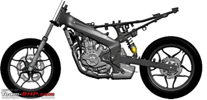

Could've added this on the previous post itself; not sure how I missed. But it is not recommended to alter the foot pegs' position towards front/back.
Most modern bikes use the engine as a 'stressed member'- meaning, the engine acts as part of the chassis as well. So in a modern single cradle- which I assume the NS200 is- there is usually no actual chassis towards the front. In other words, no bottom rail in between the center post and down tube; part of the engine effectively acts as this bottom rail. So no direct mounting points for the foot pegs.
This means that you'd have to alter the brackets' shape towards the front to mount foot pegs and pedals. This is not a recommended modification, as a poorly designed bracket can cause too much leverage on the actual mounting point on the chassis, causing either the bracket or the mounting point to break under use. It only gets worse if you occasionally stand and ride, which is plenty useful on highways too, to stretch while riding.
I noticed that the recently launched Classic 650 comes with such brackets from the factory that puts the foot pegs' position forward. There must be some other bikes that have such alterations, which you can look into for ideas. But if I were you, I wouldn't be so confident as to attempt designing one such on my own. The risk is simply too much for the reward.
This is why I had only suggested to extend the existing bracket design downwards earlier. But, by far, the best option if you want your foot pegs forward is rather the seat mod- rise and flatten the seat, and you sit further back.

Small correction. The Bajaj Pulsar NS 200 has a perimeter frame.
For reference about footpeg mounting: https://www.bikesmedia.in/uploads/im...sar-200-ns.jpg
A perimeter chassis but yes your points are valid.
