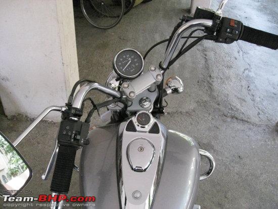

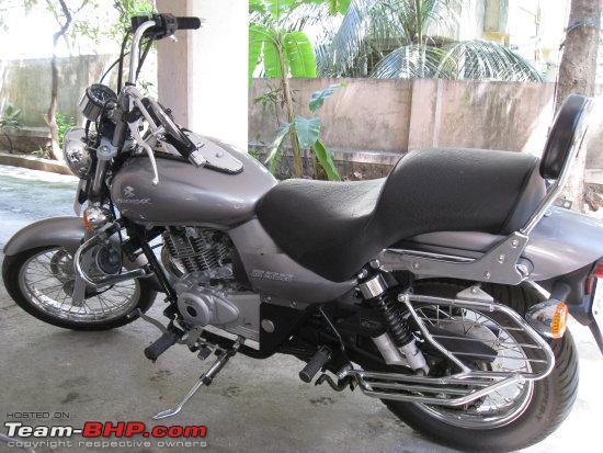

Hi Anand,
I had an avenger 180 for two years, sold it, now am riding a friends 200 while he is overseas- and with his knowledge i did the following modifications:
Modified the seats at Pawar seat corner in Nana peth. You have to tell them to put in two inches of 40 density foam over the original foam.
Changed the stock shocks to gas filled shocks. These can be purchased from Kevate spares down bhavani peth (tel: 9325010273). The shocks are of Endurance company. go for the medium (smaller) size. (I also bought a thunderbird handle from him which I fit on the avenger.)
The mechanic will have to grind down very slightly the bottom edge of the shocks to get them to slot in properly.
The thunderbird handle gives afar superior riding stance, the feeling is of staying on top of the bike in hard braking conditions.
The shocks do raise the centre of gravity by an inch or so, but I find this to be a positive as it makes for a better ride for the pillion. I keep the springs adjusted to medium (my wife is a light 45 kgs), for a heavier person you can use the hardest adjustment.
Ride quality?
Absolutely unbeleivable! I have a sensitive back and had problems on my ealier avenger, but this gives the same comfort as being on a thunderbird sans vibrations.
If you do go for the thunderbird handle (it fits, don't listen to anyone who says it does'nt) all the cables will fit, tho the disk brake cable is a tight fit. You may want to change it, but its not necessary.
You can buy a lockable side bag made by studds from Pawar seat corner.
Hope this helps.

Thought I'd add some pics ...
Bajaj Avenger- Took A Test Drive, Need Buying Advice-modified-avenger-200_2.jpg
Bajaj Avenger- Took A Test Drive, Need Buying Advice-thunder...err...venger._3.jpg
Bajaj Avenger- Took A Test Drive, Need Buying Advice-2-inches-40-density-foam_4.jpg

Yes Venkat, ride quality on the gas shocks is waaay better. You have to play around with the adjustment tho, to find the right tension for your body weight. Keep in mind the pillion rider and/or luggage.
About the warranty, I do'nt know, but I think it should not affect it as it is not directly related to the engine.

Hi Cruiserman,
Thank you for this important information. This is by far the most helpful post I have read on T-BHP. I will go to Nana Peth ASAP to experiment with my Fiero seat. If they can improve the comfort on my Fiero, I think I can safely buy Avenger and improve the seats even further.
BTW, I see that you have added more and better foam that increased the cushion and height of the seat. But has it also increased the width? Can't make that out clearly from the pictures. I think the most important problem with the pillion seat is the lack of width rather than the height of the foam. I think the Nana Peth guys may be able to handle that as well. Correct?
Regarding gas-filled shock absorbers - I just wish I had got this info 2 weeks earlier - I just replaced my Fiero rear shock absorbers to new OEM ones :-(
Thanks again for the tips and tricks. I really appreciate it.

Hi Anand,
regarding the seat, tell the nana peth guys NOT to shave off the sides of the pillion when they add the new foam but rather give it a rounded shape. This increases the width on either side of the pillion.
The gas shock works for the avenger because a) it is a gas shock b) it is a slightly longer stroke than the original stock shocks. This raises the pillion by almost an inch (more if you increase the tension of the springs) which in turn puts more distance between bumps and bottoms!
Hi Cruiserman,
Thats a cool list accessories added to your avenger...
I have been driving my friends avenger and im planning to buy one for myself..
However i have driven enticer as well and i find the handle-bar comfortable
(Which is similar to thunder bird) a quite well-curved handle-bar in holding position instead of the plain-straight handle bar in the avenger. Since it is quite straight in avenger and not curved in ends, i get a shoulder-pain as my shoulders are not well-RESTED compared to driving in enticer. Anyone faced this problem ?
Since you fitted the thunderbirds (curved) handle bar, i suppose it should be possible to fit enticer handle-bar as well...i suppose ?
Anyone tried it ? Ofcourse i cannot go for enticer (low pick up and sales stopped), and moreover i m in love with this machines look.
Anyone know of some better place in bangalore where they fit the oddest of type of accessories for avenger ?
Also anyone finding the lack of kick-start a major missing feature ?
Cruiserman/Venkat, iam really waiting for your feedbacks..
