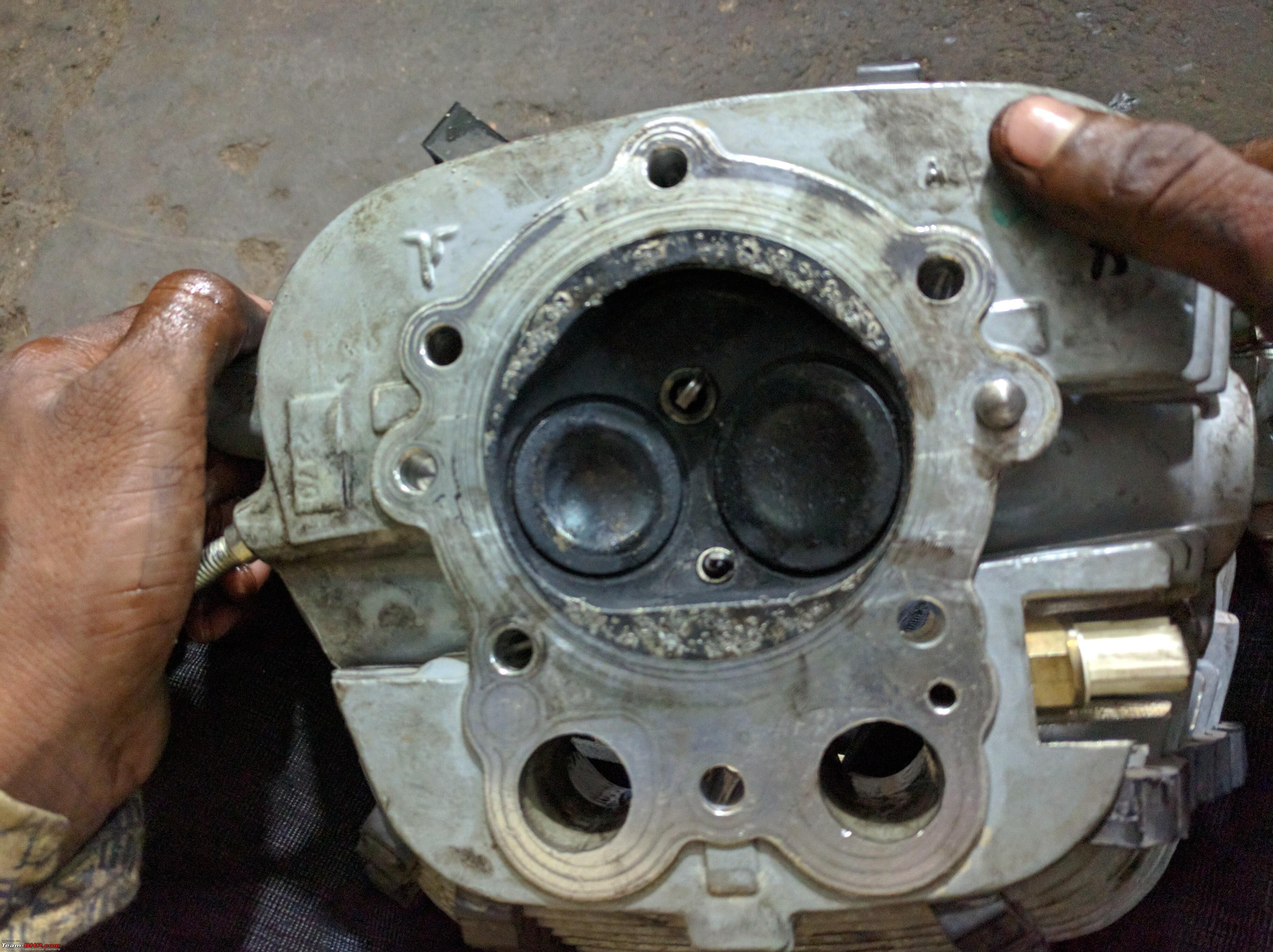

A quick update on my bike,I would have posted it sooner but I just couldn't get my hands on the laptop.
The weird sound while cranking the engine was traced to the exhaust valve not closing properly,the reason so as to why that happened is still sketchy but the most probable scenario as stated by my mechanic was that the engine might have sucked in some debris while I had removed the plugs.The said debris prevented the exhaust valve from closing completely and it was fouling with the piston.
The result was that the exhaust valve and valve guide needed to be replaced as there was too much side to side play in them.So,I got that sorted out and to fix the original issue ,as per Arizonajim's suggestion,I swapped the plugs for a set of bosch plugs with a heat rating of 8,replaced the air filter,added an injector cleaning additive to the fuel and replaced the engine oil and filter too for good measure.
Thankfully it didn't cost a bomb to fix and all of this was done for about 5K.
The encircled part is where the valve supposedly fouled with the piston.
I've ridden the bike for about 400Km(mostly highways) since the fix and it has been flawless,until I discovered that the throttle return cable has rusted and ceased in its casing,due to standing still for a few days in this humid weather I guess.
