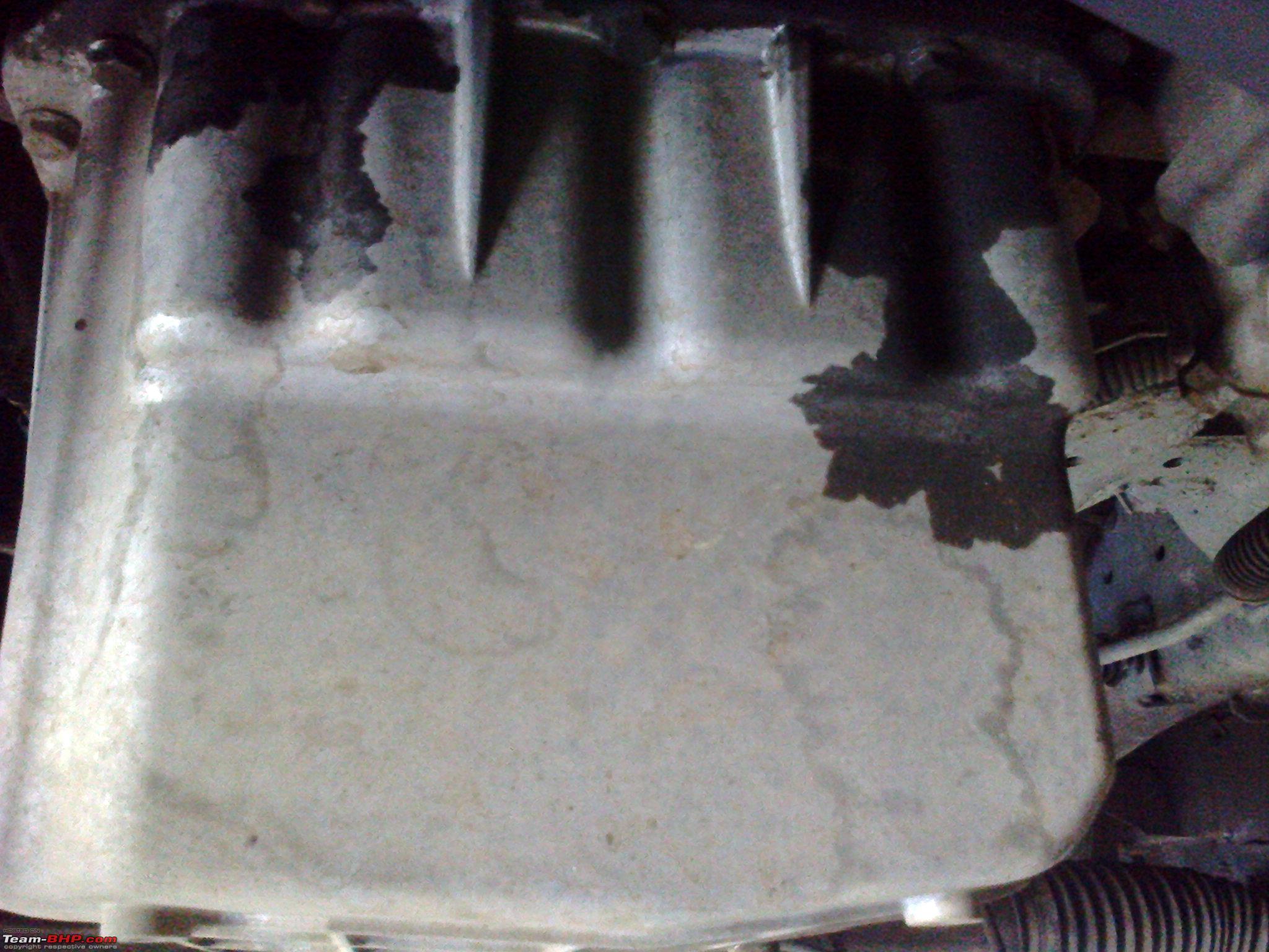

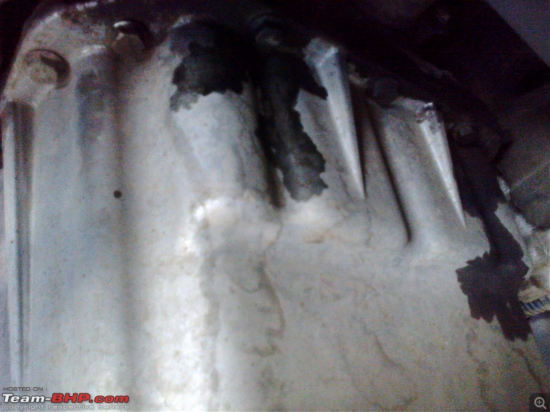

Some of the old Storme guys would be remembering the sump leakage that was discovered in my Storme in end 2013, which was cleaned, bolts retorqued, and vehicle driven for a further 800 odd kms, when the leak recurred, so the sump was disassembled and the gasket and the sealant replaced at the time.
http://www.team-bhp.com/forum/test-d...ml#post3327418
Well, that was a year ago.
Now in end February during my truck's 2nd year service, when the vehicle was raised on the ramp, we discovered two things. (1) the leaking "new improved/rectified design" rear right shocker (discussed in the dedicated thread for the same started by Tanveer); and (2) an oil weep/leak again seen on the sump, specifically mainly from two bolt holes. This time it was nowhere as bad as a year ago (see the photos from the link of the post from that time that I have pasted above), but is not something I expected or remotely wanted to see. Again. A second time. Not happy.
The sump has again been disassembled, checked thoroughly, and put back with a new gasket and sealant, and I have been told it is not going to recur. I hope so. Putting it here as a record, and so that the Tata guys who are obviously following this and other Storme threads for feedback can also take note and look into it. There is absolutely no reason in this day and age of modern engines, high precision machining, modern metallurgy, and new age gasket materials and sealants, for a sump leak like this to happen not once, but twice in a new 15,000+ km vehicle.

This leak was over a little over a year and just under 10,000 kms from the time it was repaired last.

The simpler reasons for oil leak in the sump, is bad gasket, poor fitting/tightening of sump bolts. Hopefully your problem is related to one of these. However, if the issue recurrs again, it maybe a problem of poor machining/casting of the sump or the cylinder which results in gap between the sump and bottom of cylinder block.
I discussed the same thing with them. Being a Bullet rider, I know all about head and block surface matching, and gasket leaks. We do the same on a plate of glass, manualy, figure of 8 pattern. Lots of patience, and expertise, to get a proper fit.
I don't see how the same could be applied here, looking at the size of the sump.
How big a job is it going to be getting the sump replaced under warranty (the CSM did discuss that possibility while the Waranty still held).

Yes, the sump issue is definitely the service guys, and the quality of prepping and workmanship. Unless its later proven to be a design or manufacturing defect. This is the second time. I hope there is not a third. Though my confidence has been shaken, after the promises of thoroughness from last time (repeated afresh this time).
