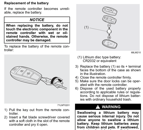

The key fob works in two ways:
  1. Active mode - uses the battery in the key fob to communicate with the car by announcing its presence to the keyless entry system.
  2. Passive (i.e. backup) mode - does not require the battery in the key fob, it works passively in a manner similar to RFID, using the car's power to let the car detect the key fob.
By placing the key fob near the start/stop button, you were using the passive mode to let the car know the key fob was inside the car, since it appears the key fob's battery wasn't strong enough to transmit a signal.
If your battery completely fails, then you'll have to use the physical key from the key fob to open the car. The physical key can be removed as shown below:
Changing the battery is also a straightforward exercise, as shown below. The replacement battery is a CR2032 type of coin cell.
I'd gone through a similar replacement for my EcoSport's smart key, and I've documented the procedure on this thread (including how to handle the scenario of the key fob battery being completely drained): https://www.team-bhp.com/forum/diy-d...s-battery.html

OK, now that makes me lean back towards a weak battery :). If you have a multimeter handy and are comfortable with it, you could check the battery voltage to be totally certain.
