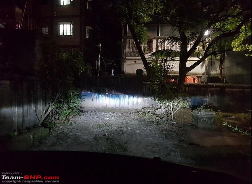

Perfect LEDs you have there. Please share the procurement details. How is the spread of headlight beam with LED? Is the fog lamp powerful compared to OEM fitting? Did you have to change the fuse for this mod? was it done at the Tata (So the rest of the electricals are covered under warranty if there is any short circuit due to these bulbs).
Additionally, for auto dimming IRVM I see that the wiring has come from under the roof padding. You had to remove this for wiring? Where is this wire connected to?
LEDs were purchased from Aliexpress. The product link is given below. Once you buy it will take around 30 days for the product to reach you. Don't buy too much items at once and do not use any premium shipping like DHL, Fedex etc. It will attract customs duty. Ask the seller to declare the value as 20-30$.
The beam pattern photos can be found at the end of the post. I didnot change any fuse. I fixed the foglamp myself. It's very easy. I took help of a accesory shop for fixing the headlamp. The connectors are direct fit. There is no wire cutting involved. Only the rubber dust cap behind the headlamp assembly was cut to pass the heatsinks. Later I sealed the cuts in the rubber with silicone sealant.No relay is also required as they are of lower wattage than the stock bulbs.
IMO warranty should not be void as there is no wire cutting involved and the wattage is actually lower.
https://www.aliexpress.com/item/Osla...746715742.html (for headlamp)
https://www.aliexpress.com/item/Osla...704067478.html (for fog)
https://www.aliexpress.com/item/170-...319110290.html (IVRM)
Now the photos for beam pattern:
1. Low beam
Tata Tiago : Official Review-low-beam.jpg
The beam illuminates the road quite well. Specially the fog lamps are much better.
When using only the high beam I feel the road just in front of the car is not illuminated at all. I also see this in your picture with high beam and without fog lamps. However High beam with fog lamp seems to solve this problem.
