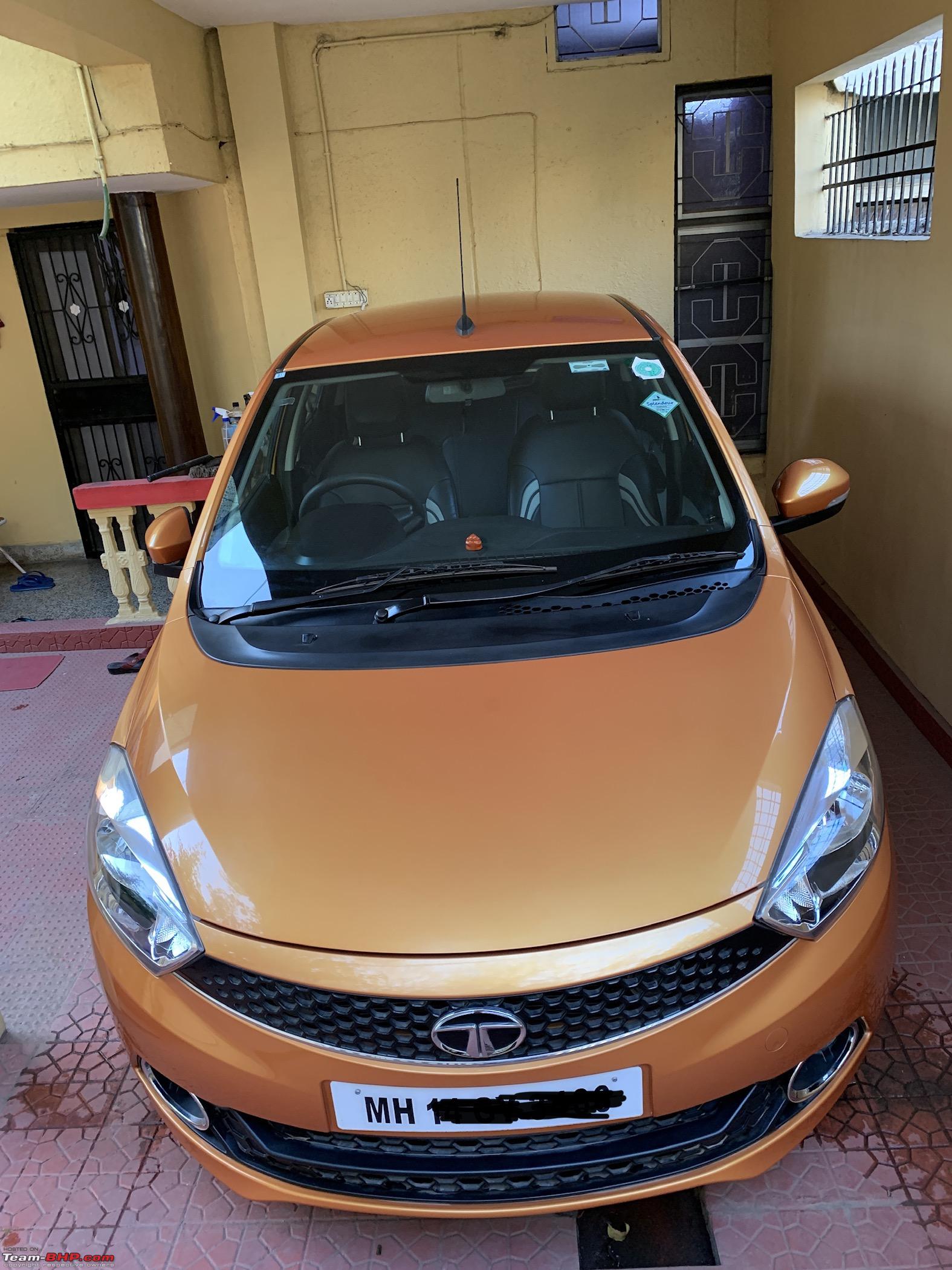

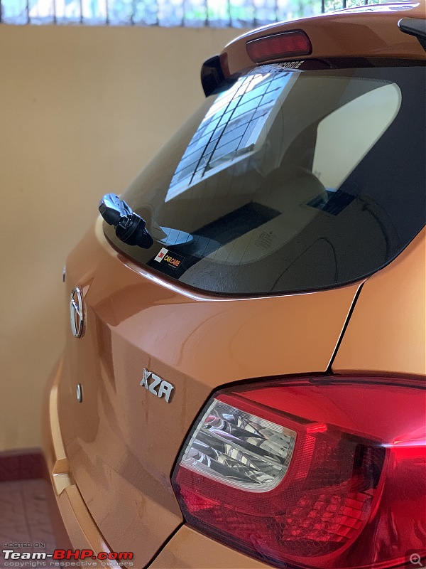

I am in Raipur for few weeks and working from here. Got some time with Tiago and below are the observations.
Tiago’s odometer is at 11750 kms after around 32 months of ownership. It came to Raipur when odometer was around 4300 and car was 4 months old.
My father is a retired man and Tiago is the sole vehicle here(which explains low running). I am trying my best to drive it more and result is 750 kms in past couple of weeks. Linea is just parked inside.:)
Tiago is a wonderful city car and AMT works brilliantly in the Raipur city traffic. I always turn AC off temporarily while starting from signals if we are on incline and more than two are seated. Revs build up otherwise and vehicle just shoots after a delay of couple of seconds.
Sport mode is awesome and aggressive push on pedal sees the rpm shooting to 4K plus and gear downshifting as per the need.
Music system/suspension/AC/tyres works brilliantly.
I am pleasantly surprised by how easy it is to maintain the orange colour! Dust just doesn’t shows and here in my blue linea, a fine visible dust just settles 5 mt after the wash and wax.
There was a minor scare when one fine day Tiago just showed engine check light and won’t start at one attempt. TASS updated the software , cleaned spark plugs in couple of visits and thankfully problem isn’t resurfaced . It’s one of the reason why I am only using Tiago since I am here.
One query here - None of the tyres on my Tiago has the manufacturing date printed. The section is just blank. During PDI, I remember checking spikes on all wheels and they were in abundance. Is this normal? Or it’s on inside?
Some latest pictures after the waterless wash.
Tata Tiago : Official Review-446486addb8e4f709172410d72ec8efe.jpeg
Tata Tiago : Official Review-738fdd41148644c7833d3fc6ff7cce4b.jpeg
Tata Tiago : Official Review-749187a802644d17a9a6322e898924f4.jpeg
