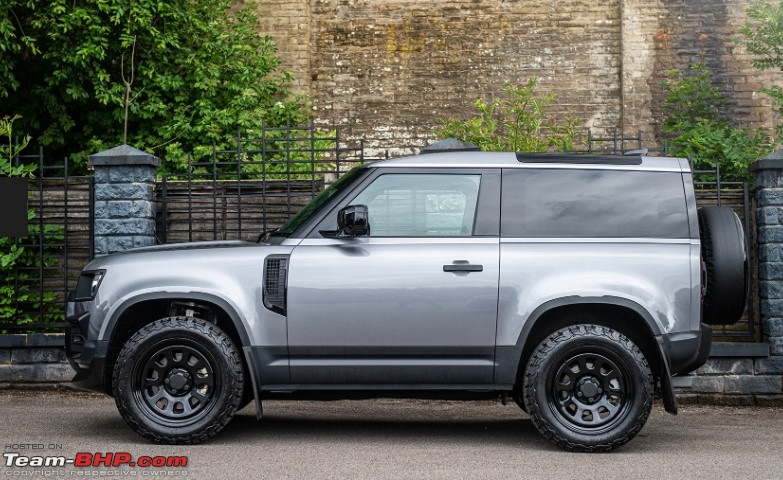

Hello folks,
I have ended up damaging one of the wheel caps on my BR-V. Any suggestions from where can I source an original piece. I searched on Boodmo but it says it's unavailable.
Originally Posted by Storm2.0 (Post 5824902)
Hello folks, I have ended up damaging one of the wheel caps on my BR-V. Any suggestions from where can I source an original piece. I searched on Boodmo but it says it's unavailable.
Take this opportunity and get rid of all the wheel caps. Black steel wheels look good on most cars (especially SUV-shaped vehicles like BRV)
Eg: Defender with black steel wheels:
Honda BR-V : Official Review-screenshot_3.jpg
Take off all the wheel caps, clean the wheels and share photos here! :)
