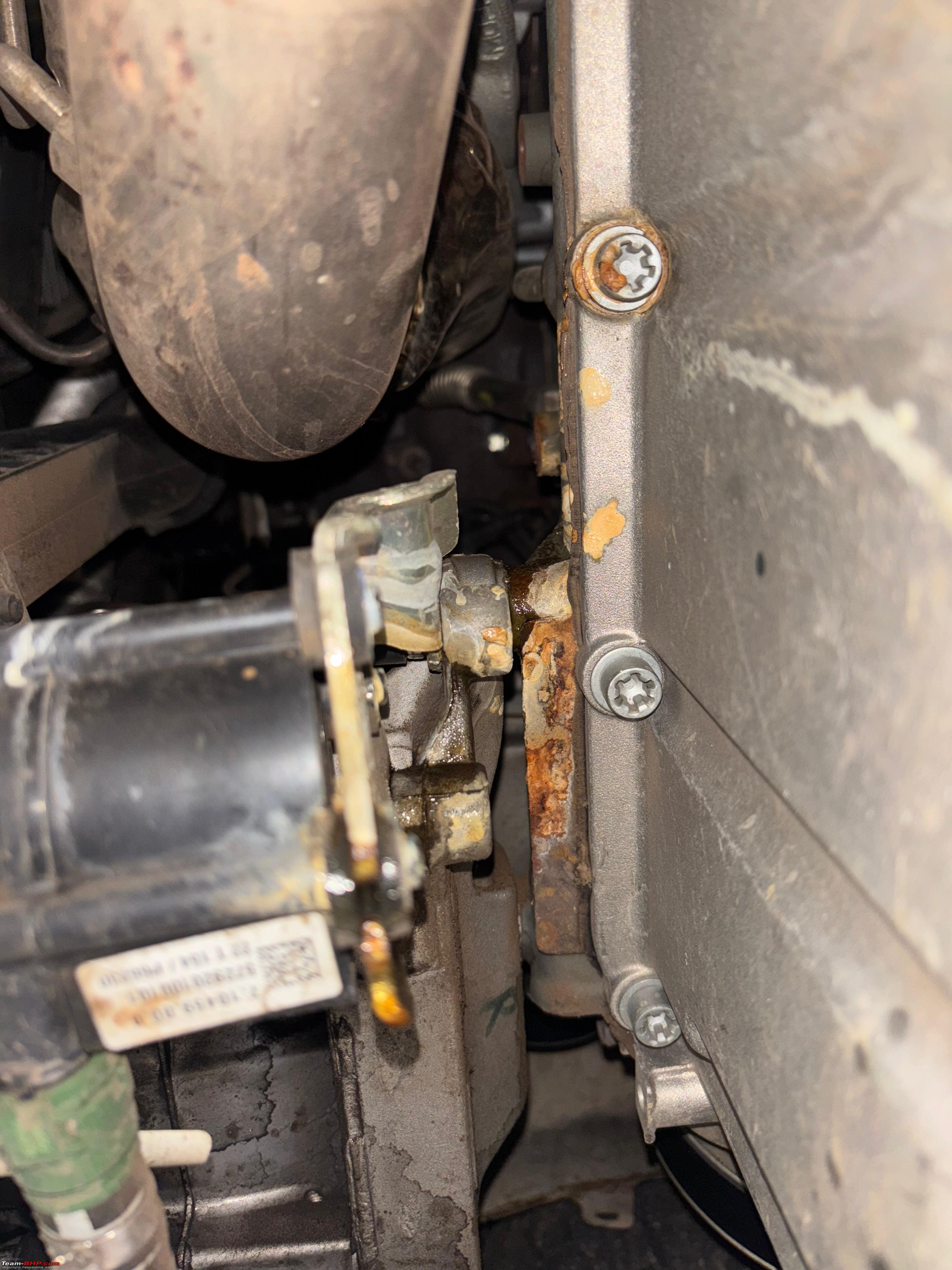

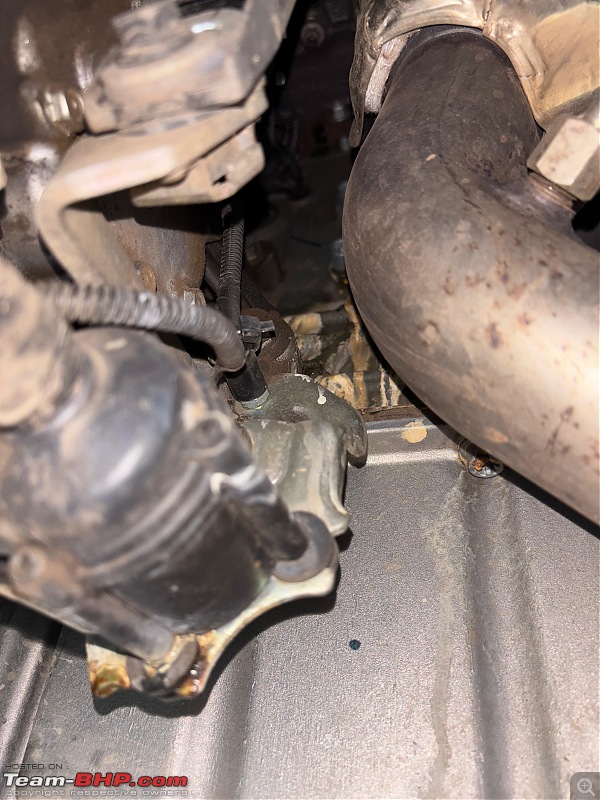

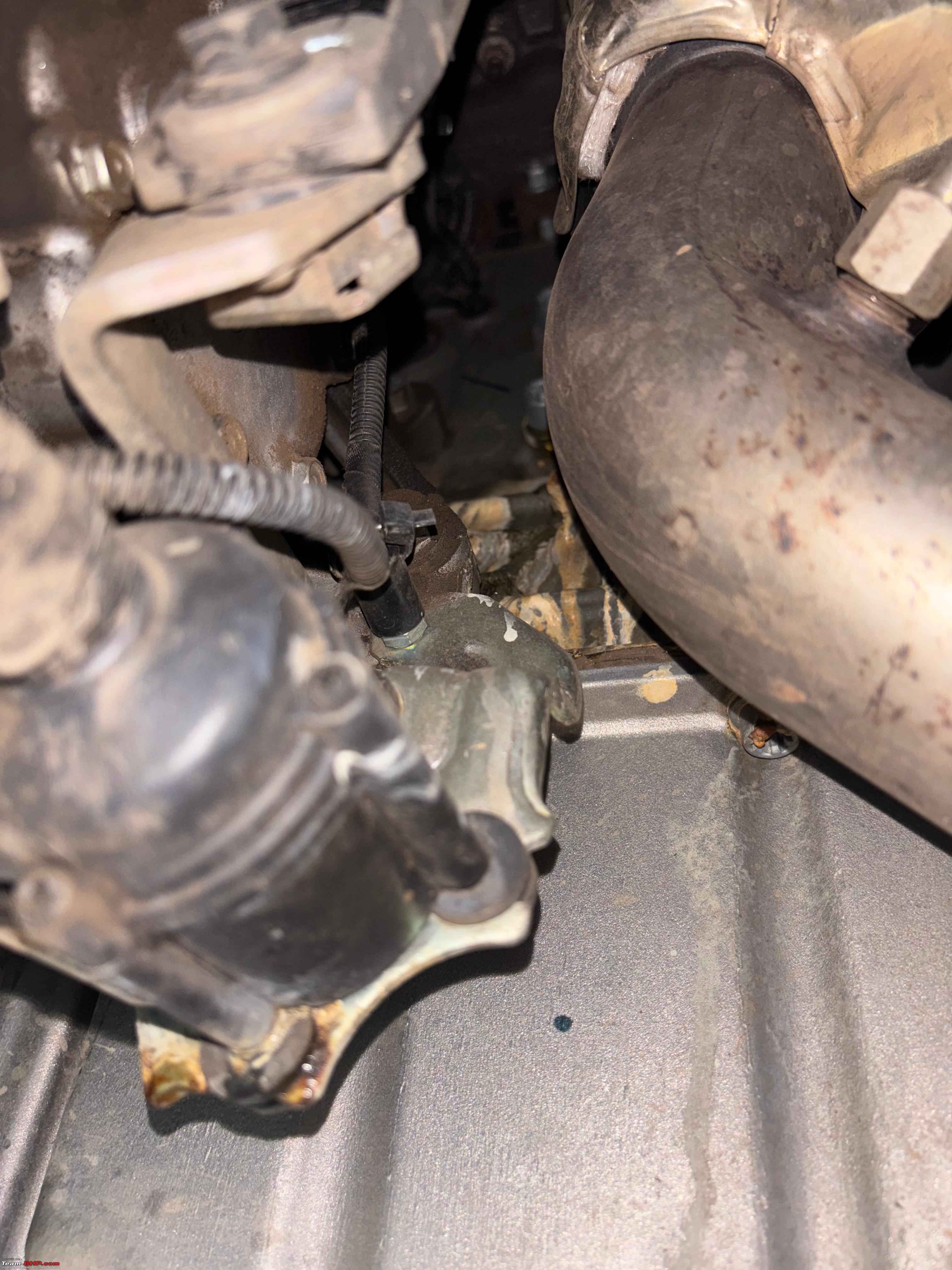

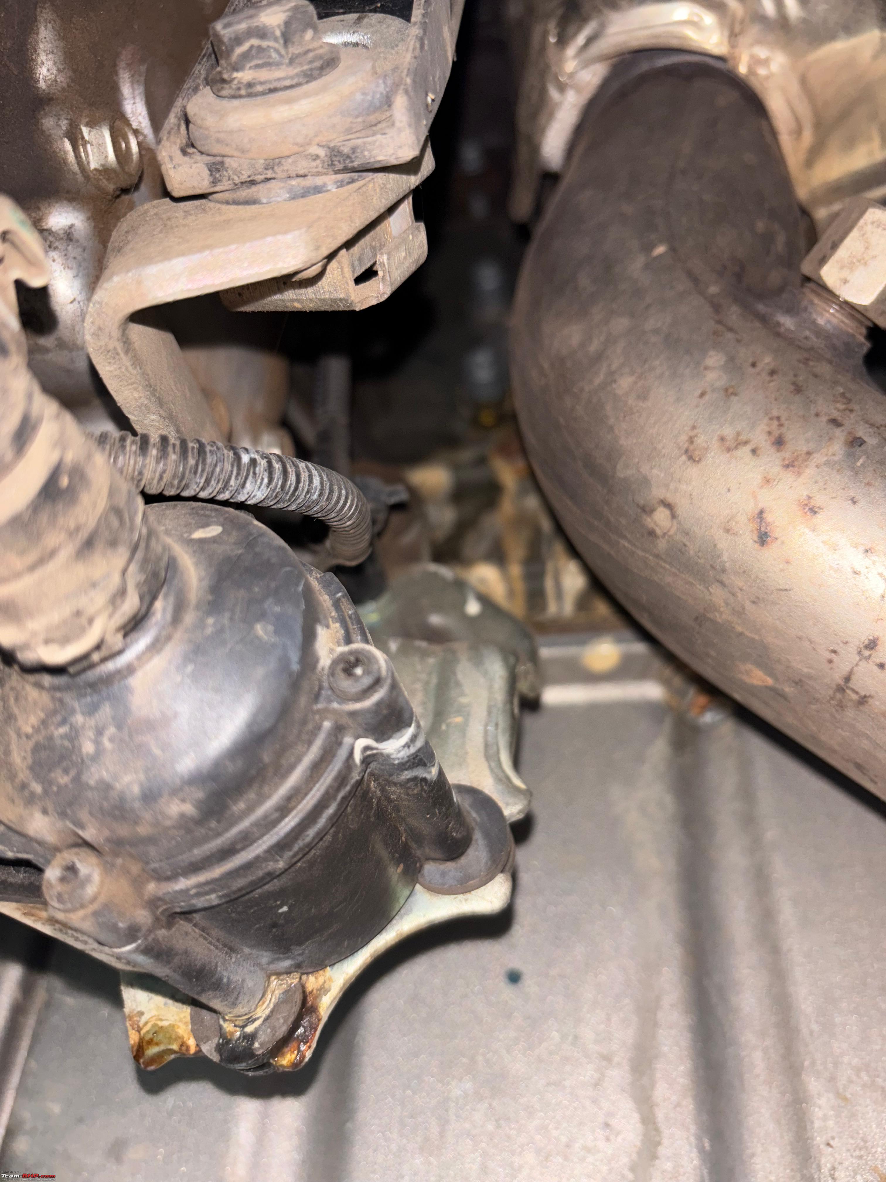

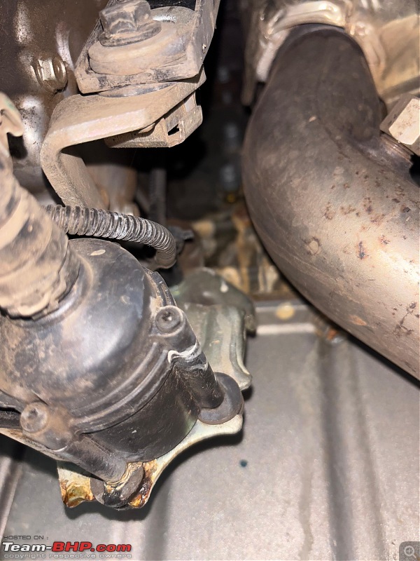

Usually it does not leak , did they say how the leak happened? Was the plug rusted?
These pictures were sent to me. Plugs look okay to my untrained eyes. Could this be a manufacturing defect?
Can be or something has caused it to rust severely, however once there is rust involved, they will wash their hands off. It looks more than just surface rust to my eyes.
