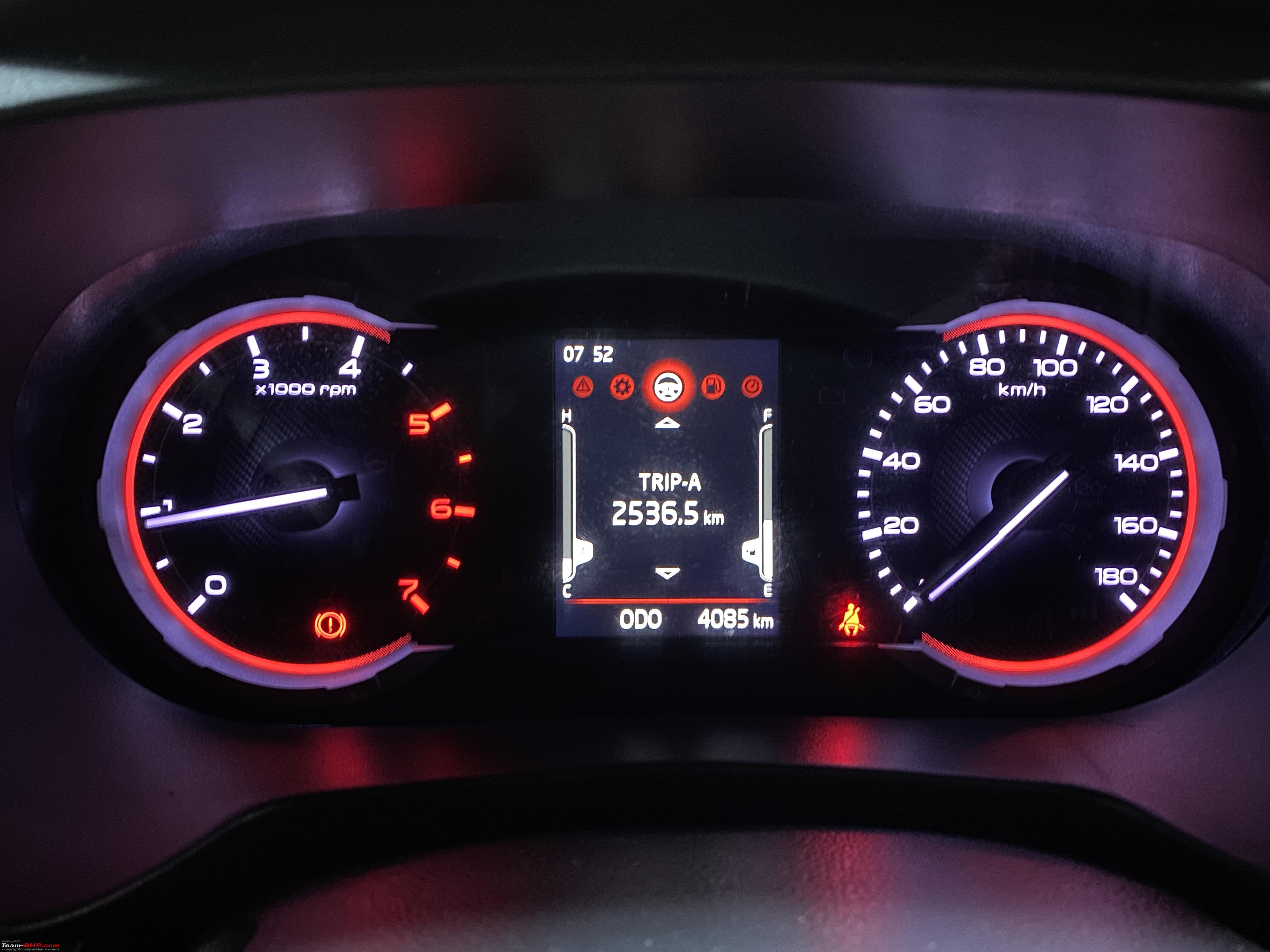

Notice the temp bar gauge...this should be the general position
