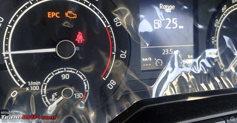

I recently booked a November'22 Slavia Ambition 1.0 AT and came back to my hostel.
My dad who is a loss assessor for motor insurance happened to be at the skoda stockyard today. He asked for my allotted car's VIN and the car happened to be there.
So when dad started it, the EPC, ECU, Cruise Control lights continued to be there. So the person at Skoda (who knows dad professionally) said that the lights can be removed during PDI.
Is this okay? Or the lights shouldn't have been there at the first place?
Please let me know as I'm stuck here.
Thanks. :)
Thanks. :)
The car is in transportation mode, due to that you have all those symbols, manufacturers put the transportation mode to limit the speed and some other features of the car during transportation. After the car is alloted to a customer and is ready for delivery, the mode is removed. Nothing to be worried about. :)
