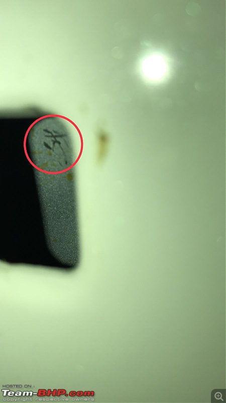

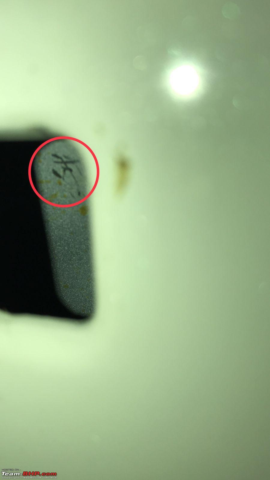

ScorpioN bonnet rod issue : UPDATE
As I have mentioned earlier on this thread about the protrusion that had come on my hood due to the sharp tip of the bonnet rod. I’m also quoting my post for everyone’s reference below,
Originally Posted by Shrey1230 (Post 5422482)
ISSUE 2
Also after a couple of weeks of usage I have noticed a major engineering fault...
After discussing the same on the Scorpio N whatsapp group, a fellow group member shared with me a detailed photo of his white Scorpio N, in which you can clearly see the plastic residue on the inside skin of the hood which is from the tip of the rod rubbing against it and which will cause the same protrusion with the course of time as it did in mine. I’m attaching the images below of the rod and the plastic residual marks as they were not visible in mine due to the shade of my vehicle.
The plastic residue is clearly visible.
The tip of the bonnet rod which pushes from the inside
And I’m also attaching the images of my makeshift way in which I’ve added pieces of heat resistant and insulating foam around the area which acts as a barrier to stop the rod from pushing in further.
The insulation foam adds a bit of thickness
The foam strips act as a barrier to stop the rod from grazing from the inside
I hope this post helps everyone understand this issue better and can help any current/future owner prevent this from happening to their new vehicle. Mahindra offered me a hood replacement but I have politely declined as no matter what good a job the MASS will do it’ll never match up to quality and more importantly the colour matching that was there when the vehicle rolled off the line. I’ll happily get the bonnet rod changed if Mahindra decides to reengineer it in some way!
