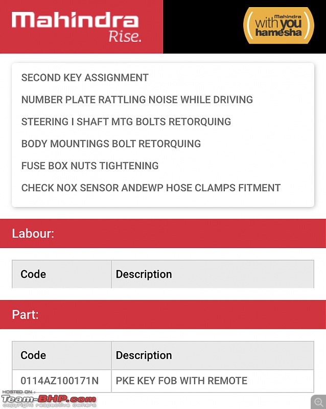

Hi All,
It appears Mahindra has issued a recall for steering rattling/feedback issue. I brought the car in in today get the second key and number plate changed (they had not installed it properly at the time of delivery). Today when they took the car in and generated the job card I noticed various torquing activities listed there and then I asked SA , he explained It’s all part of the recall and they’re fixing it for customers in phased manner apparently. I had explained this issue to them in the first service but they said it’s normal and what not and the same person tells me Mahindra acknowledged the issue and are fixing it. Also he told me there will be a recall for the headlamp issues as well. I was like - wow , took you sometime but are finally getting around and listening to customer who’ve been highlighting this for sometime now. Attaching screenshot for my job card. Note that the only thing that was supposed to be there was key fob and number plate , everything else is what they added as part of proactive checkup/recall.

Good to see Indian brands like Mahindra finally trying to make their customer service as robust as their products of late by taking customer feedback seriously. I too was surprised to see the seat tumble RO on all ScorpioN’s after I reported it on mine on the day of delivery. And going by the initial first month reviews, I feel the first batch of ScorpioN is relatively better tested and less niggle-y than compared to that of the last few launches my Mahindra & Mahindra.
