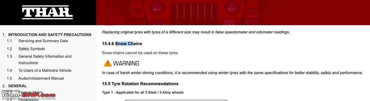

Regarding the Snow chain issue, Thar base model is compatible with snow chain as mentioned on the website but the top end is not. The same is mentioned in the manual. I agree, in fact I pointed the same points, with fellow bhpians about the car not being designed for hardcore off road usage because of components placement and low ground clearance but snow chain application is not recommended even on the thar.
I have used snow chains on my xuv 500 at jalori pass without any issues, even though the manual said otherwise. The main thing is to be careful not to snap the break line and damage any parts while attaching the snow-chain.
One more curious thing is that the apterra ht2 in the scorpio n 17 inch size is rated for snow as the sidewall mentions it.

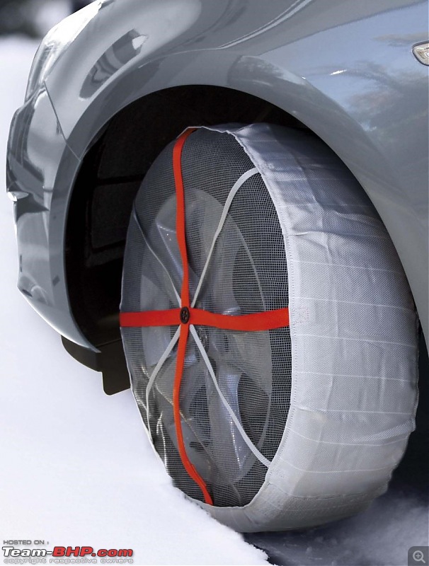

Don’t think these would pose any issue to any tires or vehicles. Various options are available in such tire chains.

With chains I am talking about good quality imported chains we use, these plastic contraptions are for reel life not for real life. Many cars dont take chains in front wheel wells, its alright till the car has space on rear wheel wells where I recommend chains first.

I've tried the plastic straps on my Tata Nexon earlier this year, but they broke off in just a few spins of the wheel. On the other hand, have been seeing some good reviews for "Snow Socks", such as the one here. Will be ordering a pair from Canada next month, and will post a review towards the end of the year when I field-test them on my Scorpio-N.
