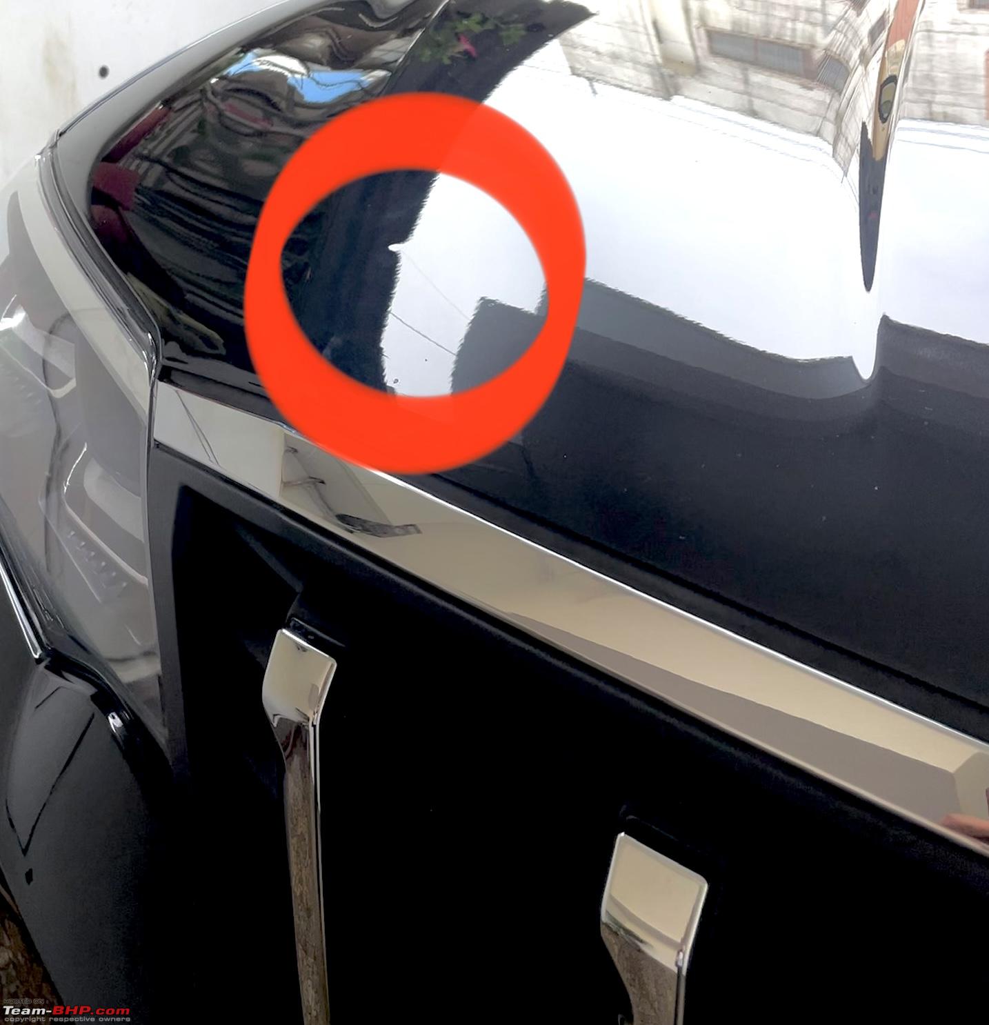

ISSUE 2
Also after a couple of weeks of usage I have noticed a major engineering fault on Mahindra’s end; the part where the hood support stick locks into the bonnet, the sheet metal or skin of the hood in this case is too thin and is not reinforced from the inside around that area. And since the hood is so heavy and the plastic used on top of the stick is also pointy, in just a mere 4-5 times of the hood left being open for not more than 5 mins at any instance, the surface has gotten a “pimple” protrusion on it which is not only an eyesore but also worries me because, as the vehicle ages the bonnet will keep pushing the skin to the point when the paint and clear finally gives in and chips away. This is a major flaw and goes on to show why hydraulic struts are crucially important on such a heavy hood. Attaching the image below of my hood with area with the protrusion encircled, notice how the reflection of the shed is not straight and has an “indentation” which is the protrusion.

What color is your Scorpio N? Can't see it clearly in the pic, can you pls send one where the entire hood can be seen?

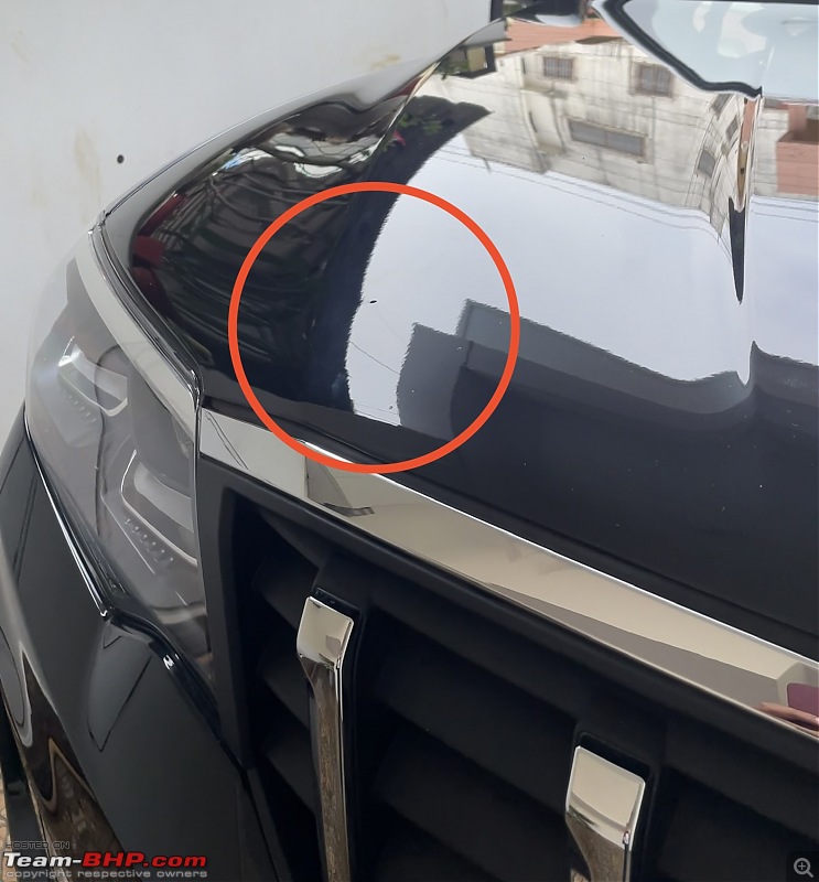

I have it in Napoli Black, attaching another photo with the protrusion more visible, clicking a photo of it is really difficult as the camera of my phone auto-adjusts the reflection to make it look normal. I hope it is more visible in this one.

May be this problem can be addressed by putting in 2 mm rubber washers on the bonnet rod such that it locks in the space and also does not touch the upper part of the hood. You can use feviquik or similar strong glue and then trim off the washers to match the existing lock size. Just a jugad.

Once the protrusion appears, the washer isn't going to help. In my view, this is a design defect and Mahindra must replace the entire hood, along with a new design of the rod.

I understand brother. If the damage is done, this won’t help..atleast those who have not experienced this can try the jugad.
