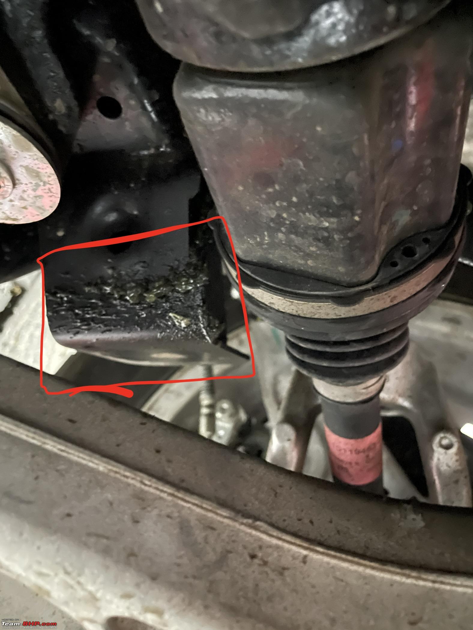

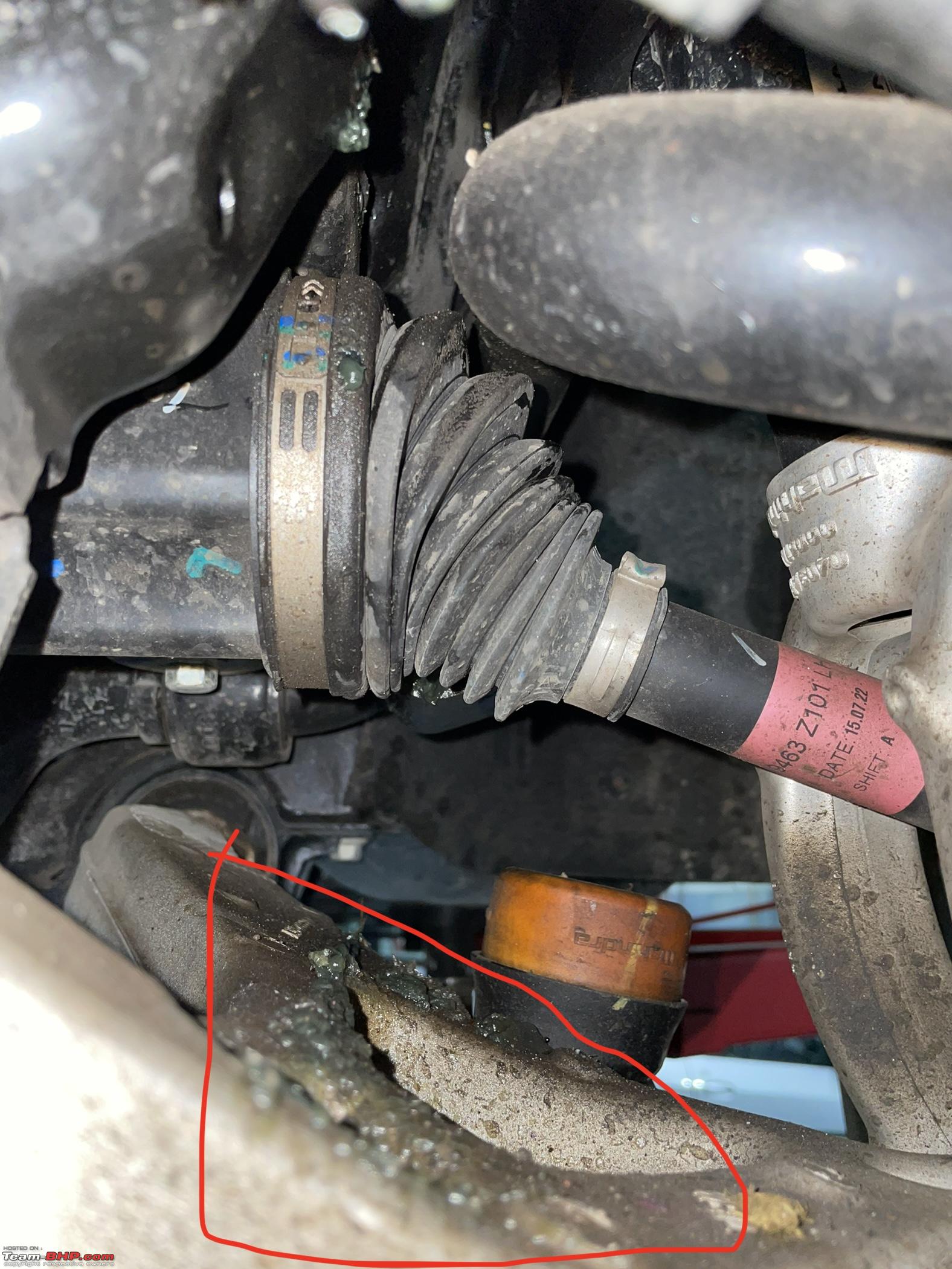

The alignment issue was taken car off, and then came a series of major issues that stunned me. The car was lifted and straight away the front left arm boot was found punctured. Grease was spread all over and that was a mess. The service advisor told me that it’s good it was detected now as there was still a lot of grease left and it wasn’t running dry.
The rubber part wasn’t available but they called up another service centre and arranged it and replaced it under warranty.

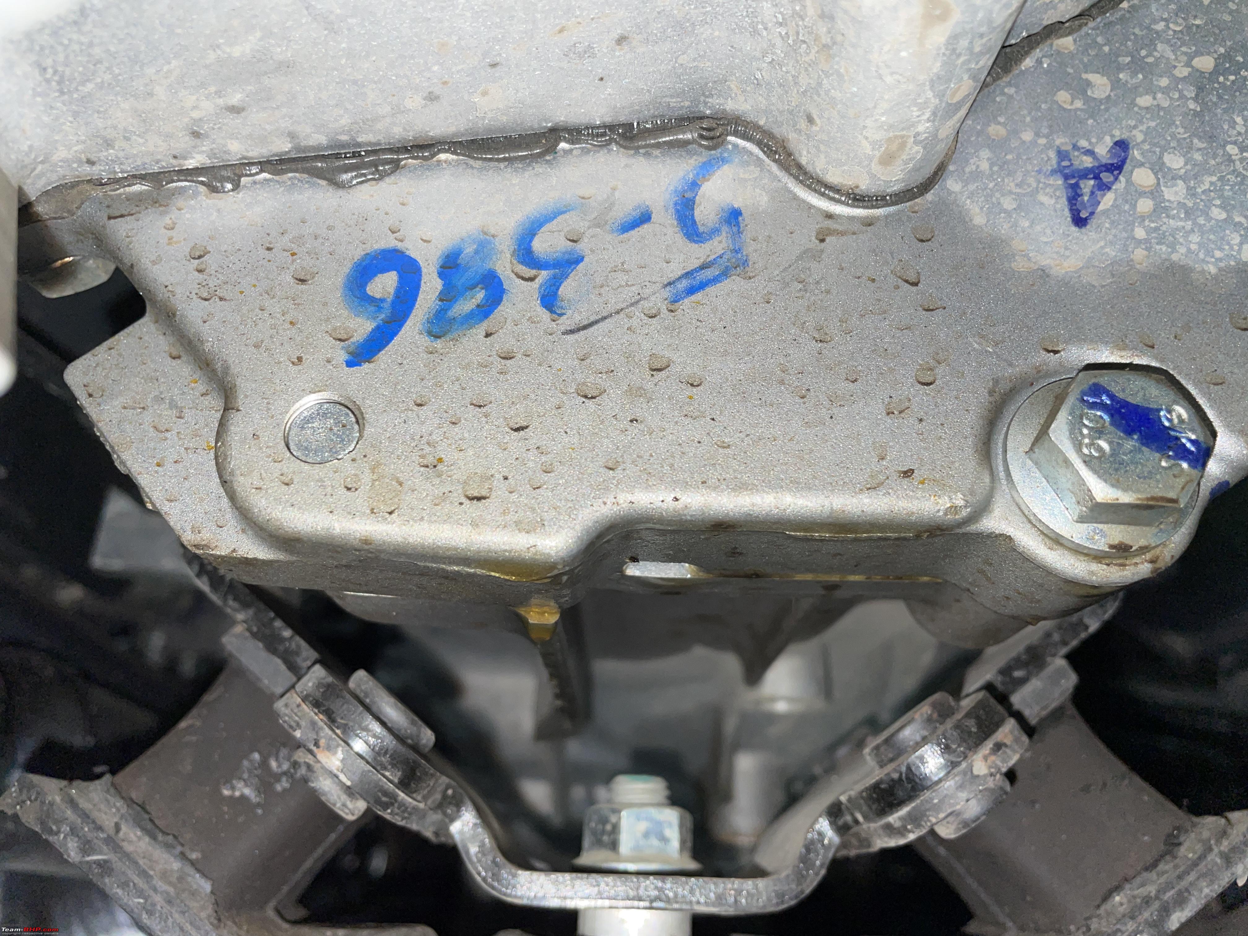

The next issue wasn’t detected by the service staff. I was looking at the underbody carefully (as I usually do at every service). I found some grease below the transmission.
Upon touching it I felt a huge lump of oil in the chassis.
Close inspection revealed the transmission gasket paste was improper and that was causing a leak. The transmission oil was not at appropriate levels and it was thanks to the 1000 km service interval that this issue was detected. If I drove more who knows what major damage the transmission would face.
I know first batches are prone to problems but these aren’t niggles. These are serious mechanical flaws that don’t happen in a new product. These are production line and quality issues.

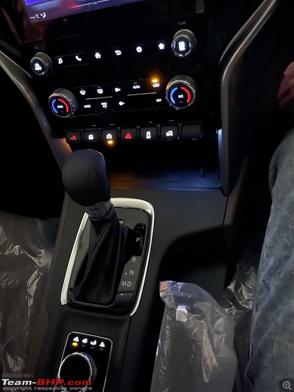

In My car, PRNDS console backlight is not working!
On my first day of PDI , I had brought this to the notice of the service executive but I was told it’s not backlit in Scorpio N , so I didn’t think much about it.
But after delivery I saw a YouTube video clearly shows that they are backlit.
The console looks same as in Thar and the backlight turns on only when the headlight is on. Please check if it works with headlights on.
I checked but no, it does not.
