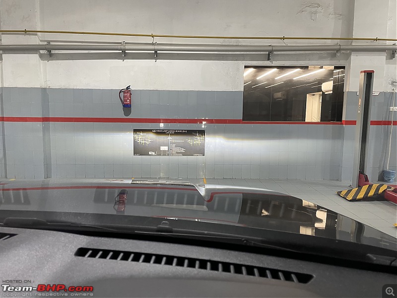

So went to the service centre first thing in the morning. A brief test drive and the guy immediately noticed the off alignment. That was rectified.
Then the headlight assembly was checked for focus. It was way off from the level it should be at. The first picture is shows the low beam the second picture shows the high beam. I have highlighted where exactly the focus of the lamp is.
It’s way below the low beam
And the left light is lower than the right one plus it’s also not aligned well horizontally.
The solution for this was really easy and quick.
There are a couple of screws on the back of the headlight assembly.
One for height adjust of the beam. And one for horizontally adjusting the beam. The car was parked in front of the light chart, the lights were adjusted and the issue was rectified. So it’s an easy fix but shocked to see how the company didn’t do it before deliver The vehicle.

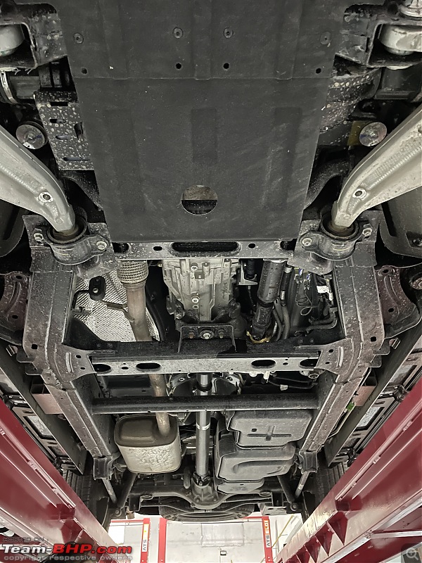

For those interested. Here is a shot of the 4Xplor version from underneath. The chassis is protecting the transfer case and transmission well. A good sump guard with oil drain cut outs.
One thing Is it’s a bit flimsy. Will report any issues I face.

Good to see the underbody pics and good to know there is adequate protection.
What underbody coating/rust protection is recommended? 3M? https://carcarestores.3mindia.co.in/...erbody-coating
Are there underbody parts that should not get any coating/rust protection because they will fail if they are painted/coated?
Thank you Kushgandhi,
Please could you send pictures of the adjustment screws for the headlight, vertical and side to side please? Many thanks
