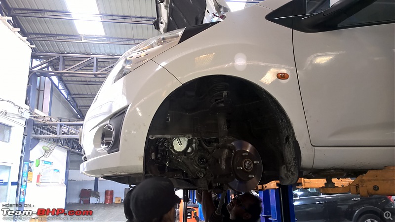

So finally at 53757 KMs our Beaty underwent a major surgery today.
Problem: Difficulty in shifting gears from 1st to 2nd and 2nd to 3rd at times. Power delivery was normal, no clutch slip or burning and no dip in mileage too. During last 2 services SA Somnath repeated that a Clutch Overhaul will solve the issue. So finally plunged.
OEM clutch would have easily lasted another 10000+ KMs. But the gear shifting issue was getting into my nerves. Sometimes launching from a red light ends up with followers honking from the back while I fiddle with gear lever and clutch.
Parts replaced:
1. Clutch - 1028
2. Pressure Plate - 1117
3. Bearing - 892
4. Flywheel - 5715
5. Clutch cable - 415
6. Gear Oil - 1175
7. Gear Lever :Frustrati (Gear grip of our Figo which is just one month older than our Beat looks almost new after 6.8 years) - 1737
Labour : 3500
Discount : 5% on Spares & 15% on Labour
Total damage to the wallet : Rs. 17,096/-

IMO, The replacement of flywheel, pressure plate and gear oil could have been avoided.
You would have got the same results without replacing them.
17k is too high for a clutch work in Beat.
Hope the problems are eliminated now.
This decision was made after so much deliberation on whether we are going to keep the car for many more years or not. Then came to a conclusion that there is no point in selling off her since the car is running same as ever before and slowly wife will take care of her.
The decision to change flywheel along with pressure plate was taken after inspecting them closely. There was uneven wear marks and with new clutch it would have aggravated and end up in another overhaul in near future. But nonetheless to say the flywheel costing is a daylight looting :eek:.
Yes, car is back to showroom piece now. With new gear lever :D it is butter smooth to shift gear.
