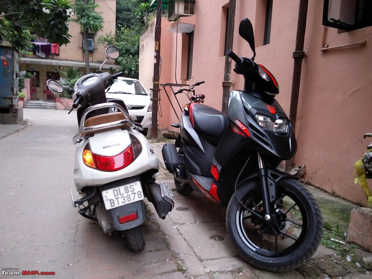

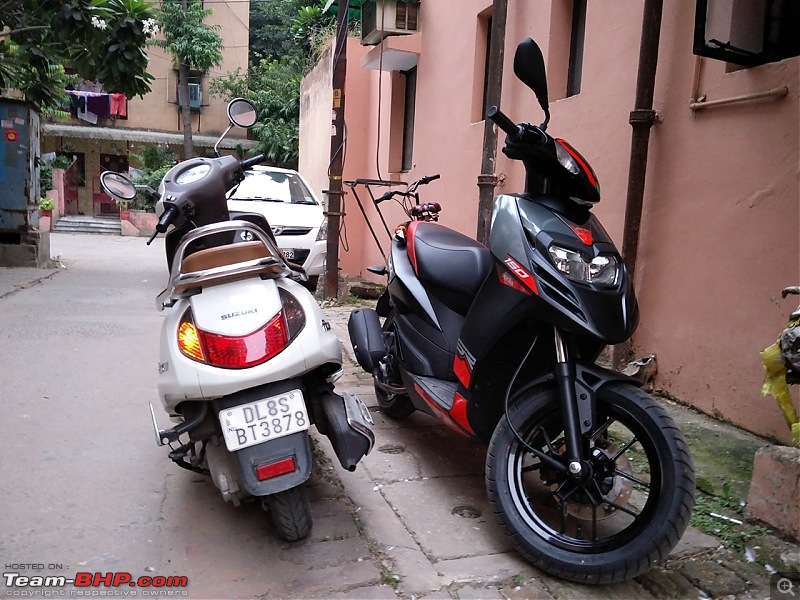

It was just after my class 12 board exams that i decided to get a car for my daily commute for coachings related to upcoming entrance exams. My suzuki access125 was serving me fabulously but due to my eye allergy to extreme heat and dust i decided on getting a car. Parents adressed the matter and agreed on a small car in a budget cap of 2-4L. Delhi’s summers are extreme and will take away all of your energy when you commute on a 2-wheeler in summers add to this, you’ll reach your destination drenched in sweat, the wind blast does no good,might get you sick instead.
My Access 125 posing with a friend’s SR 150Hyundai i10 Kappa2 : Test Drive & Review-5e05b4089b4f47c6867887ae5407dbcf.jpeg
