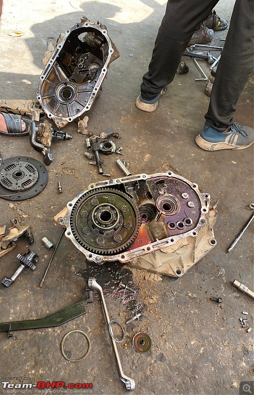

Now on my drive to Chandigarh from Delhi I was about to make a quick overtake, slotted into 3rd from 4th from that yummy slickshifting gearbox and past I went, now about to slot back to 4th and the gear lever won't come out of the 3rd, that was one scary moment as the car I just overtook was just on my tail. Somehow managed to come to a halt on the roadside, could not diagnose the issue. Burned the clutch and took of in 3rd from a complete standstill, found a garage on the way but they too couldn't get the lever unstruck. At crawling speeds of 40 I reached Chandigarh in a couple of hours and handed over the car to my fng.
Next morning I get to know that the teeth of the gears had broken off and there was way too much wear and tear , suggested me to get a complete new gearbox upwards of 60k. Damn it was an i10 manual giving me chills of a VW/skoda DSG:eek:

Hyundai i10 Kappa2 : Test Drive & Review-img_1616.png2.jpg
Spot the missing teeth in the cog.
I couldn't afford a brand new gearbox, I insisted on getting one from a doner car, it took them a week to find a perfect example and was all done for almost 18k Rupees, replaced the radiator,AC cooling core and the housing frame. Car ran butter smooth then but after knowing all the "secrets" of the car, I was just not confident enough to use it on the highways, my family was also insisting hard to let go of the car and I agreed.
