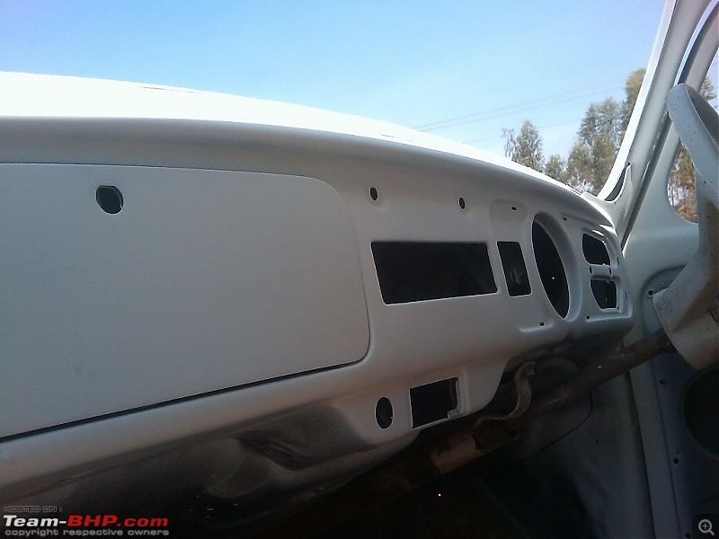

Well, other projects around delayed some work on the Beetle, but its now ready to go to the Mech's place to attain its own horses
Will update with better pics tomorrow.

The painter found some more uneven spots on the surface, so work re-started in rectifying them.
Again, its time for sanding down, applying polyster putty, sand it down again. And later will the Final coat of Surfacer + Base coat. By Monday the work should be completed.
