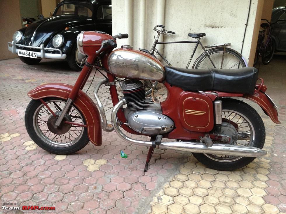

Growing up, I've always been fond of the Jawa - trademark maroon colour, twin tailpipes with that familiar metallic 2 stroke exhaust note and streamlined looks. Even though I already have a rather rough 74 model, today we were lucky to get our hands on this lovely 1969 example. We took delivery today from the first owners, an Irani family who run a popular bakery down the road. I was lucky to get a comprehensive history file including original delivery note for a Rs. 4511 and 70 paise, original warranty copy, and even the first insurance copy amounting to a princely 28 rupees and 50 paise.
The bike has been very sparingly used, very clean, with no history of being hit. It was painted 18 years ago and has settled into a nice, aged appearence. The bike seems very original to me, though I don't know much about these models and would appreceate if the Jawa gurus can guide me on what is incorrect. I assume the speedo is one of them.
Looking forward to hearing feedback on how I should go about things, what should I look out for mechanically, what should I be careful about and so on.

Congrats Karl , pretty nice example i would say ,well taken care of .
The bits missing on the bike from the originality bit are the following
Speedometer - came with a black and white dial Yenkay .

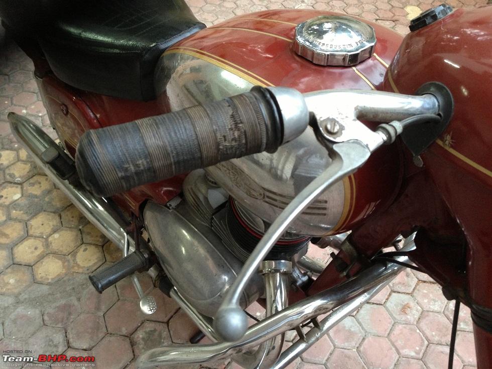

Levers - were non ball ended aluminium ones
dim-dip switch cover -Should be metal ,chromed ones
Petrol cap - Bakelite one needed
Horn - was a HT made 6V chrome grilled one
Rear footrests -Rounded ones
Exhaust nuts on block- need to be aluminium flower type ones
Chain guard - you need the rounded one .
Ignition switch needs to be the ali nut type -0-4 position
these items will get you close to 100% original , but nevertheless to find a bike in this shape in itself is getting tough these days .You dont really need any restoration but just need to add the missing parts and you are good to go
The tail light seems to be fitted way up , cant figure out why it looks that way
Good luck .

You've found what most of us can only dream of! She's in lovely condition! You even got a matching maroon head gasket!

Thanks. Any help sourcing these parts will be welcome
I never noticed it till you pointed it out. Could the mudguard itself be fitted wrongly? Could it be from a Yezdi? Could it just be mounted in the wrong spot? Sorry, but I really don't know the details on these bikes, and its high time I do!

Hehe, the previous owner learnt from an old timer to always paint the top fin of the block red, so that if the bike is at a garage, a crook mechanic cannot replace parts between bikes, or something to that effect Originally a Bombay bike, been in Pune for years.

Karl it does not look like a yezdi mudgaurd, its not fitted properly parssy is absolutely right here, but none the less you have the OE tear drop jawa tail light.
Bike looks to be in pristine health and well maintained by the parsi gentleman.
Mounting can't be wrong. This is an aftermarket mudguard made by monkeys. Unfortunately the monkeys made a lot more than just mudguards. There's a lot of these available, and they just don't fit right. You might need to cut and re-shape it or just put it in the bin. I had the same on my Jawa, but threw it out when I managed to get an NOS original.
Also works as a discreet touch to identify your maroon Jawa amongst the hordes of maroon ones at a Jawa Club meet. "I'm with the Redhead!"
