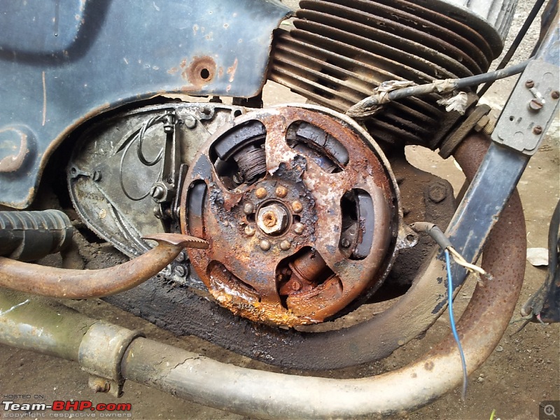

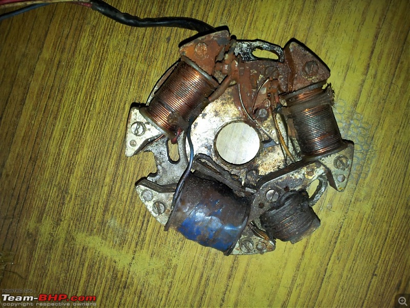

Update as on 21.09.2013:
As i had mentioned earlier, the bike was a non runner for quiet some time. Besides, she was standing in the farm for almost 2 years with practically no protection whatsoever. Time had taken its toll and therefore the kick too was jammed.
When we got her to the mechanic, the first thing that we checked was whether there were any traces of oil in the engine. Luckily there was some oil and therefore one tension was over.
When we opened the clutch cover of the bike, I was shocked to see that it was completely filled with water and mud and therefore rust had now taken over on absolutely all possible parts.
I am posting some of the pics that we took at that time:

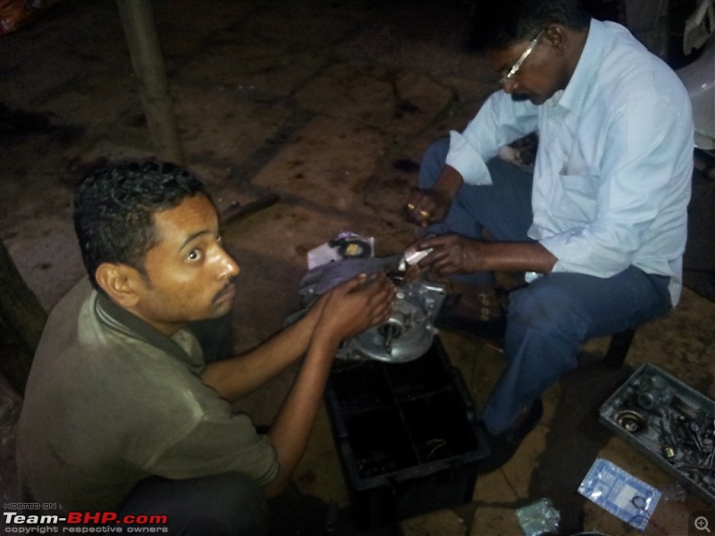

Day 3 of restoration:
After the engine was dismantled, next thing was to send the block for boring and the piston was to be replaced. Along with this, the crank needed to be refurbished and we needed a new connecting rod.
Also, water had done some substantial damage and therefore all the bearings needed to be replaced. Similar was the case with magnet coil and we found out that the starter coil had gone kaput.
The clutch plate and pressure plate had no life left and therefore they too needed to be sourced.
