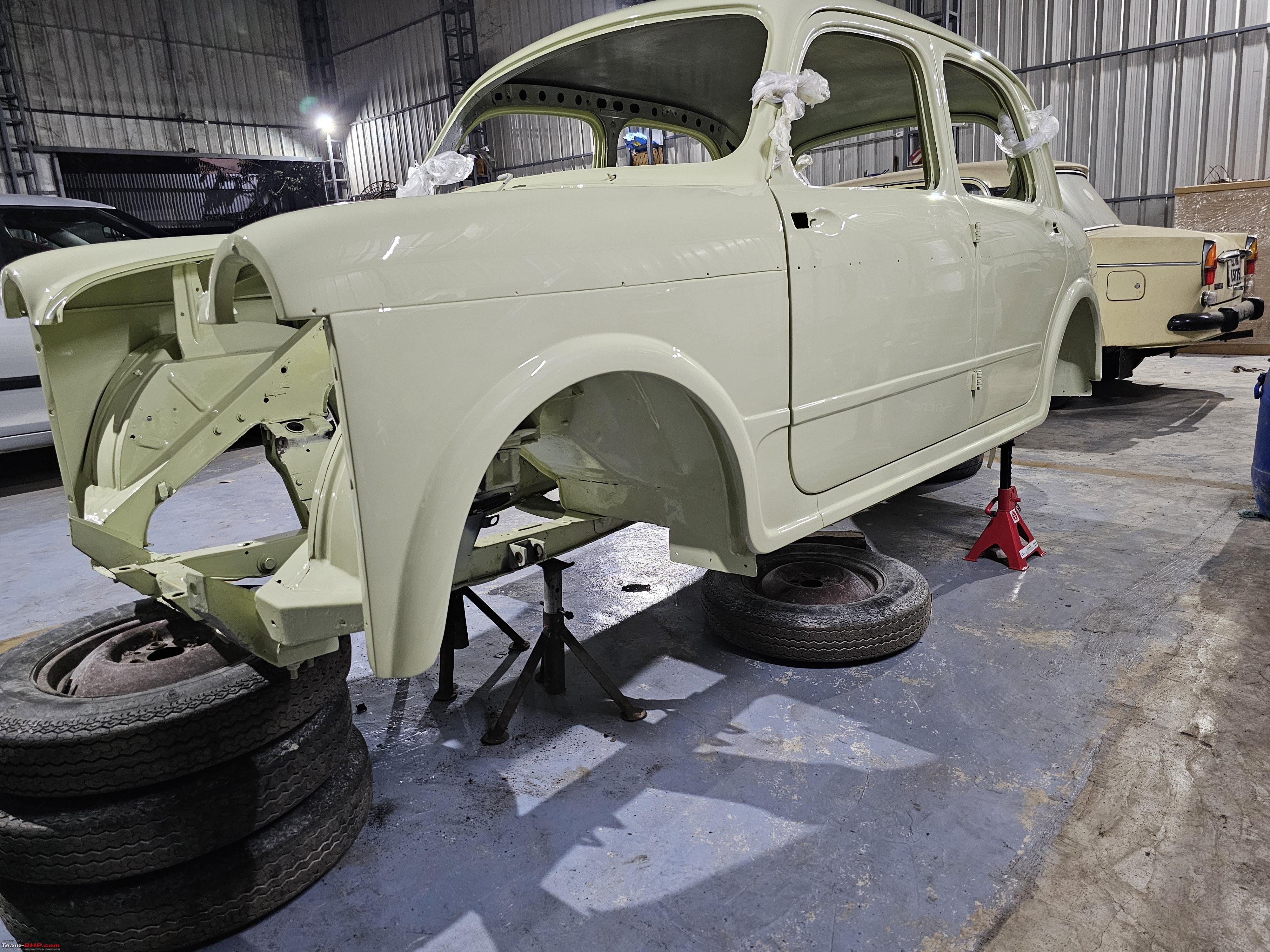

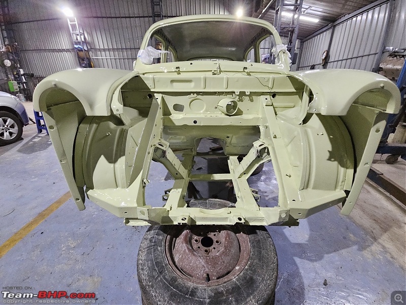

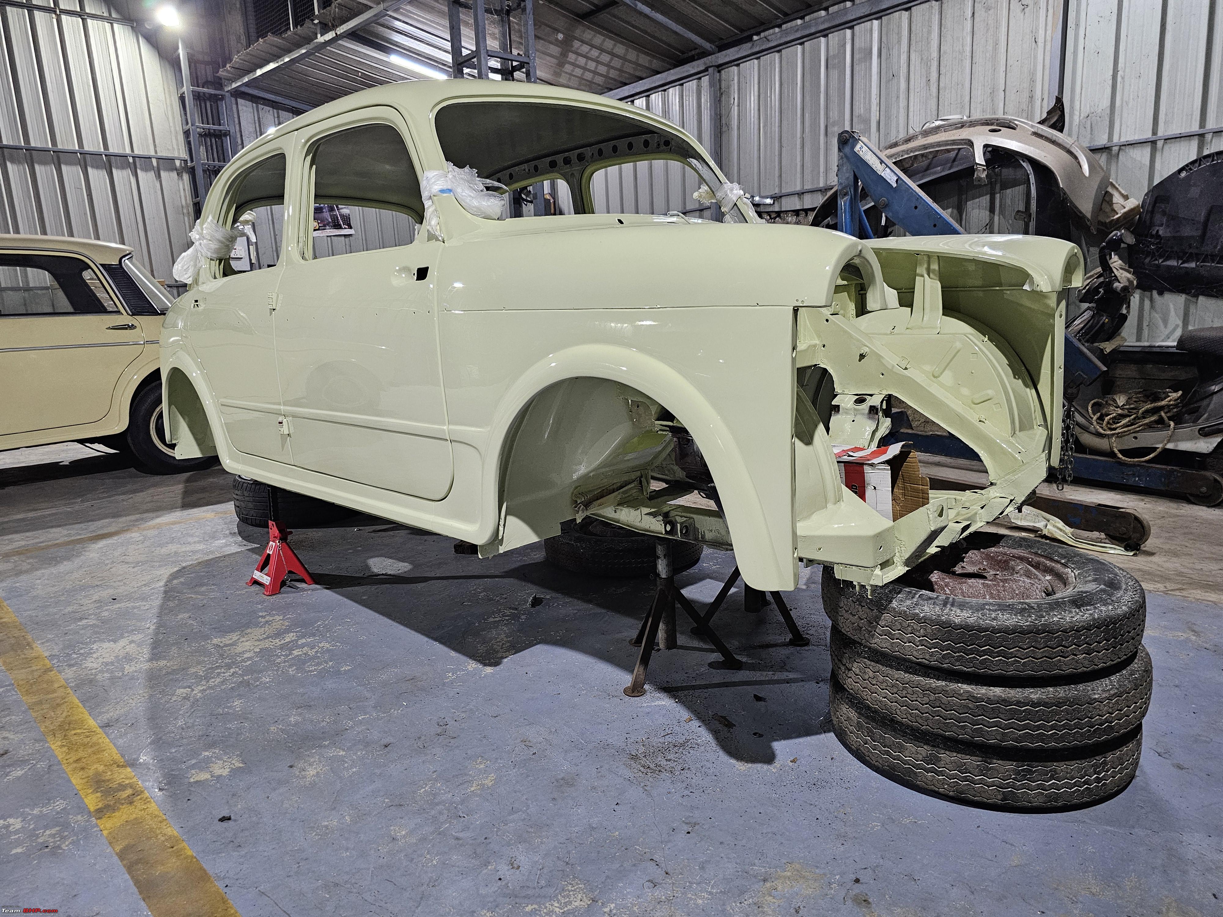

"After applying the fourth coat of clear paint, the final stage of painting is complete, allowing the vehicle to progress to the mechanical refitting phase.
I was fortunate enough to receive support from VOLKSWAGEN WORKSHOP AUTOMOTIVE in Thrissur, where the owner, a friend, generously offered the use of their space and facilities.
Although their specialization lies in new-generation cars, they graciously provided me with access to their equipment, including a lift, tools, crane, and more.
Transporting my car via flatbed, I relocated it to their facilities situated approximately 12 kilometres away from the painting shop. The following day, my mechanic initiated the meticulous task of disassembling the suspension, differential, axles etc.
Ideally, this disassembly should have preceded the painting process. However, due to logistical constraints with the location of the painting booth, it became a necessary post-painting step.
It demanded 6 to 7 hours of exhaustive effort to fully dismantle the suspension, leaving only the car shell intact.
Now, each component will be carefully loaded into my EcoSport—the poor thing has borne quite a load—and transported back to Cochin.
There, every part will receive individual attention: powder coating, fitting with new seals and bushes, ensuring readiness for installation in Cochin itself. Choosing Cochin for this comprehensive process seemed logical, given its superior infrastructure and wider availability of parts, minimizing the need for multiple visits to Thrissur.
Once all the components are primed, I'll return them to Thrissur for final fitting. I'll keep you updated as this process unfolds."

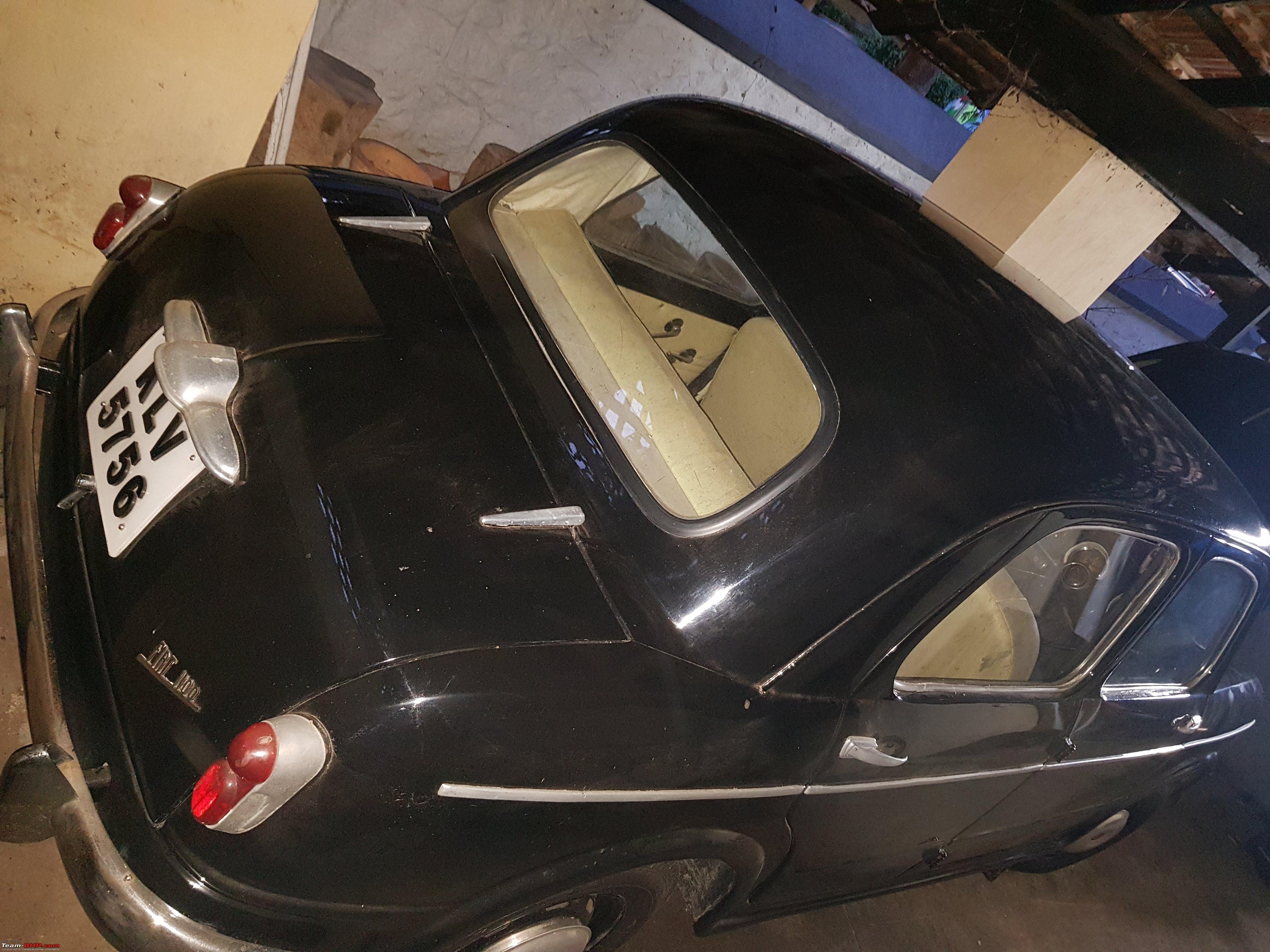

Picking up a millecento was never in my mind as i had just completed a full on restoration of my daily driver 1969 beetle which i own since 2002 . I shall be posting the ownership details and other details as a separate thread as this thread is all about the MILLECENTO!
On december 6th i get a call from a friend and owner of AUTOGENIE ,trivandrum Dilip that his friend is selling a millecento which was restored few years back and he hasnot been able to use it since he is abroad and couldnot come to india due to the covid scare and wishes to sell the mille to someone who will love and take care of her.
These are the first pictures i received through whatsapp
Attachment 2142925
I saw this pic and i was like wow and decided to go to trivandrum where the car currently is and pick her up Asap!
I reached there around dawn next day , she was kept in a closed garage for about 2 years so it had dust and some debris
pictures taken when i first met her
Attachment 2142897
Attachment 2142898
Attachment 2142899
I didnt try cranking her up and she had been idle for couple of years so i wanted to make sure she was all good (fluids ,belts ,timing etc before i fire her up
i had to wait for a couple of days for the paperworks to be completed and i shuttled between trivandrum city and poovar club mahindra (where i stayed )
So the day came when i could take her out of her hibernation and me and my friend dilip managed to bring her out to the gate
